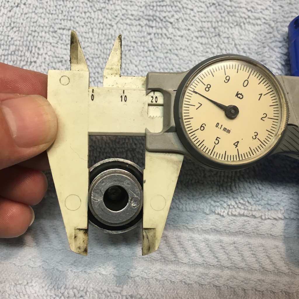

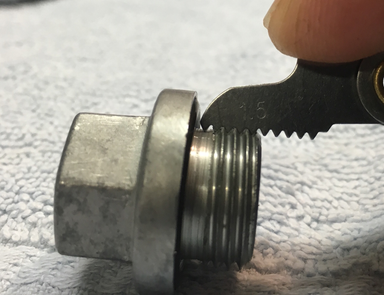

Here are the best pictures I could get of the oil galley plug size and thread
