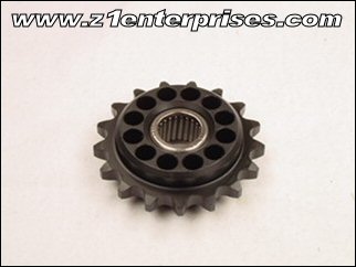

The sprockets can go bad. I put in Liska rolle sprockets. They don't come apart like the stock ones.

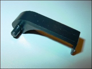

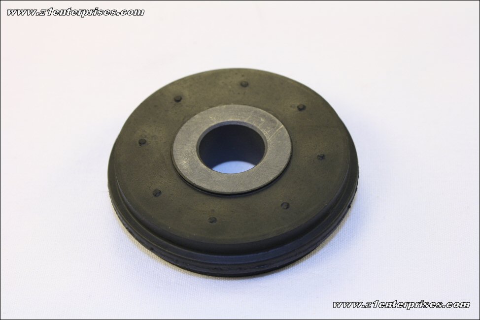

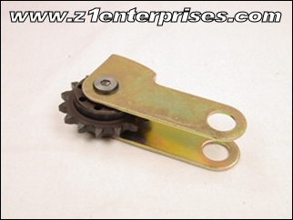

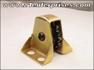

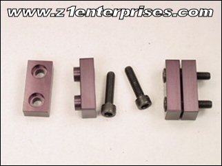

THIS IS NOT AN AREA TO SCRIMP ON. I was thinking the same. It's automatic. They can have issues. It is also possible the rollers are worn and falling apart. Putting in used ones will only buy a little more time. You've said you don't keep bikes for long and I don't know about your state but if I bought the bike from you and I found you've been in there recently evidenced by the RTV. there was a catastrophic engine failure, I could sue you for the full price of the bike and damages caused by negligence. A broken cam chain can be life threatening.
This is what I bought for my bike.
www.z1enterprises.com/store/model/kawasa.../engine/engine-parts
The Liska products last a lot longer and are 1/2 the price of stock.
$500 or so will save $1000+ in broken parts and or damage.
Word to the wise.
Word to the wise.

The sprocket rollers are rubberized to make them quiet. The rubber gets brittle and comes apart between the inner and outer steel parts. The tensioner roller is rubber, that's what is the dangerous part. It can wear away to nothing causing a cam chain breakage. The center rubber one goes away too creating slop and allowing the chain to "whip". Also the small guide in front will break causing the same effect and allowing the chain to grind on the head. I had one break and went through the time and expense of changing valves, guides and related components plus buying all the cam chain gear mentioned above. Like they say, "penny wise/pound foolish." :whistle:

I bought it in 75, it broke in 78. I guess 30,000 miles. While I was at it, I went 1015 over bore. The tensioner was gone as well as the front guide. I didn't know about the Liska gear so I paid FULL RIPPING RETAIL.
