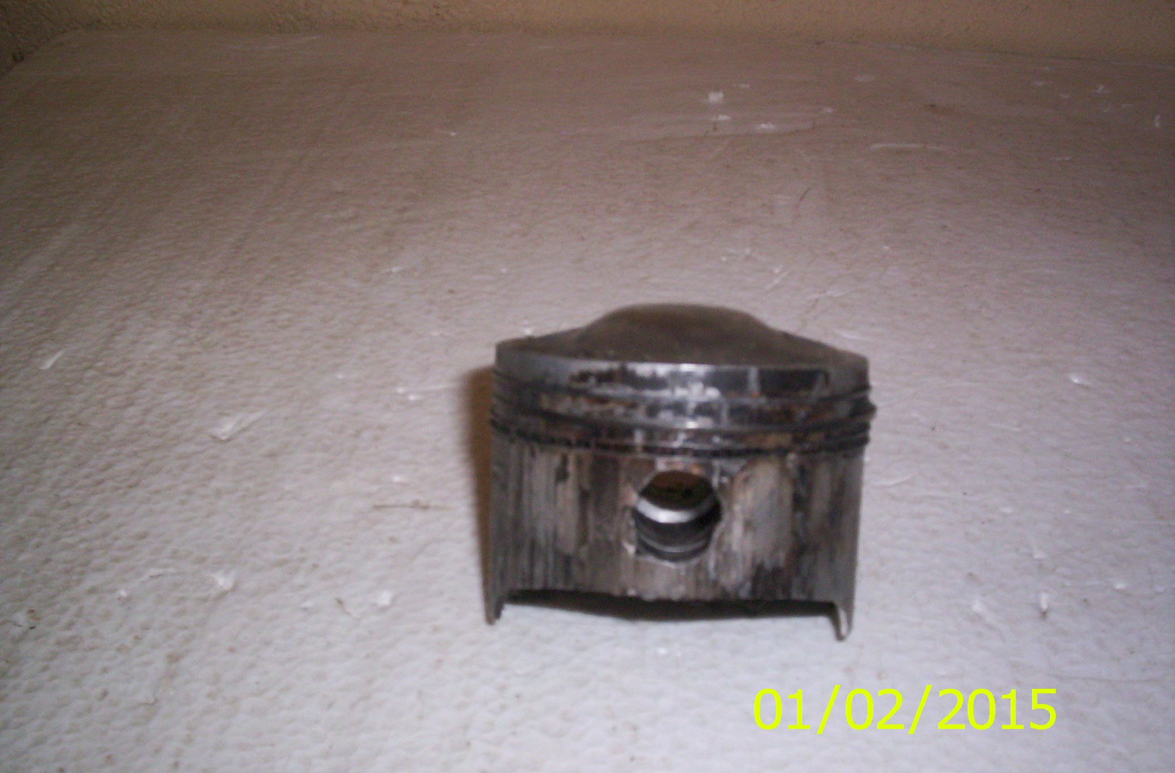

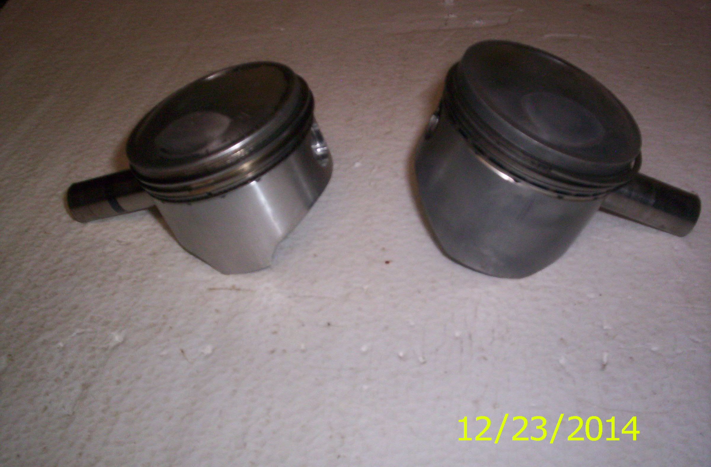

Yeah, he should have known better. $250 in parts? You made out.
Cost me $500 in cam chain components that I bought first, then I found a lunched piston. Another $500 in pistons. Wiseco doesn't make cast ones anymore.
:woohoo:
Then I had a oiling problem and lunched another one..
At that point I decided not keep track of what the bike is costing me. I bought it in 75 for $2300, rode the piss out of it, sat under a tree for 15 years and the DMV charged me $500 to get it on the road.
Basicly I got the bike for $500, what I put into it, wheel bearings, engine parts, etc, cost me less than what a running one would and I know what is going on between my legs. Good deal all considered.
