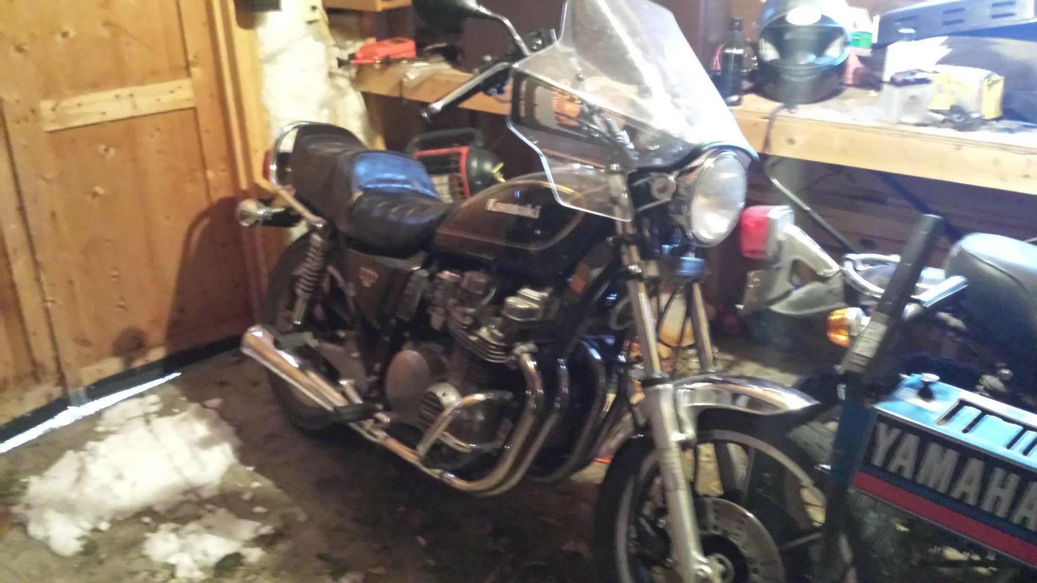

Re: kz750 clutch
02 Feb 2016 17:05
Pics?

The only one I have so far, my sd card I had that had the pictures of it last summer got wiped somehow. For the life of me I can't figure out how to flip it ride side up either!

All my pictures were stored on the SD card on my phone and when I swapped it to a new phone poof....all gone

Don't know it's just a bummer I had some nice ones of her all polished up in the summer sun
now just have a dusty garage photo lol. Well I'll change the oil and get the cable all adjusted and go from there.
