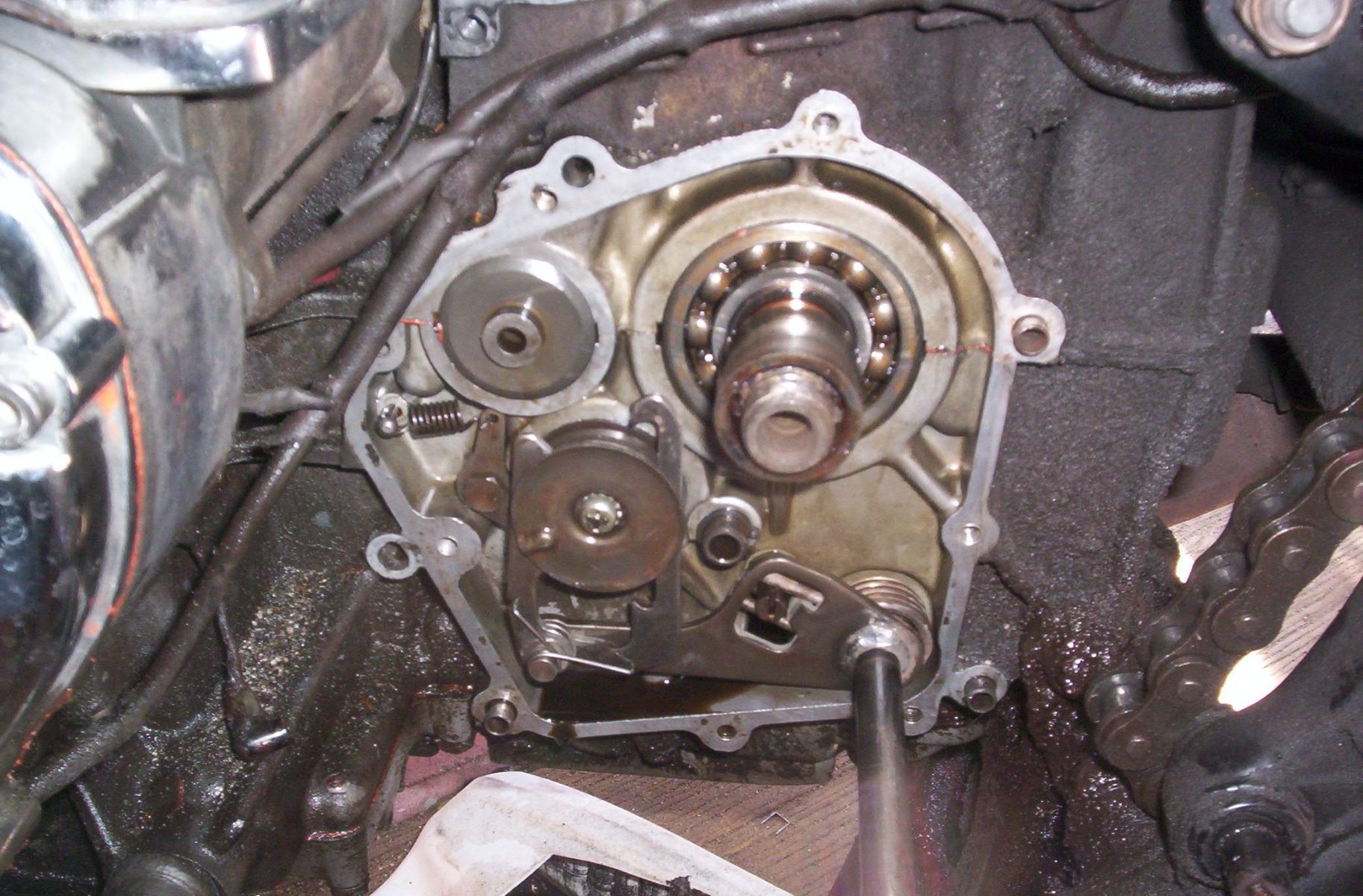

02 Feb 2016 06:31swest wrote: Might have to rock it. Just testing to see if the spring is doing it's job. Is it limp? If not, it's OK.
Sorry - not catching you. Rock what? Which spring? The return spring? the return spring is totally disengaged, and I have to push the gear shifter up to shift, then back down to center, then up again, into order to shift.

Re: no return spring = can't find neutral
02 Feb 2016 07:48 - 02 Feb 2016 07:49Thanks for the photo. Yes, I do need to do that - it must have gotten disconnected, and I completely forgot to even touch it when I had the transmission cover open. That was my question- whether that could have anything to do with not hitting neutral when the engine is firing.swest wrote: Then you need a new spring or get it on there right.
02 Feb 2016 07:54
You can see the ratchet forks. They have to return to rest before they can do anything else. Take pics as you go. It really helps for reference.
