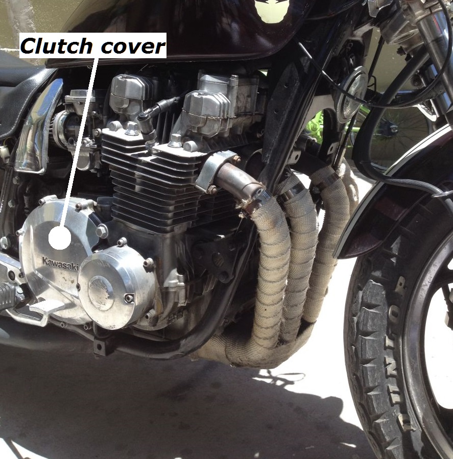

maybe this is gonna sound very hilarious but I cant remove the disc clutch cover, bolts are stuck.
It's a damn headache.

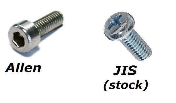

If the screws are stuck, try soaking them for a couple of days with Kroil or some other good penetrant. A hand impact driver is also a great help. If the cross-head screws are still present on the sprocket cover, be sure to use a JIS bit or a suitably modified Phillips bit.

The clutch cover and the screws are Allen.

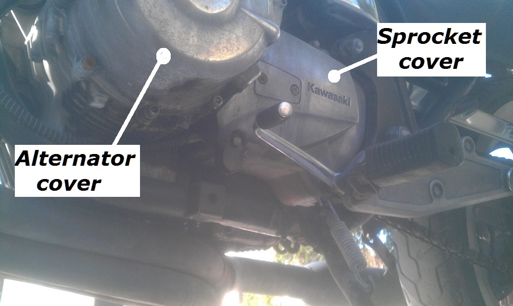

The oil leak that I mentioned is from the alternator cover and it goes from there to the sprocket cover.

You can buy a new grommet for the alternator. It takes cutting the wires and soldering them. If you decide to do it, start a thread so we can guide you along.
