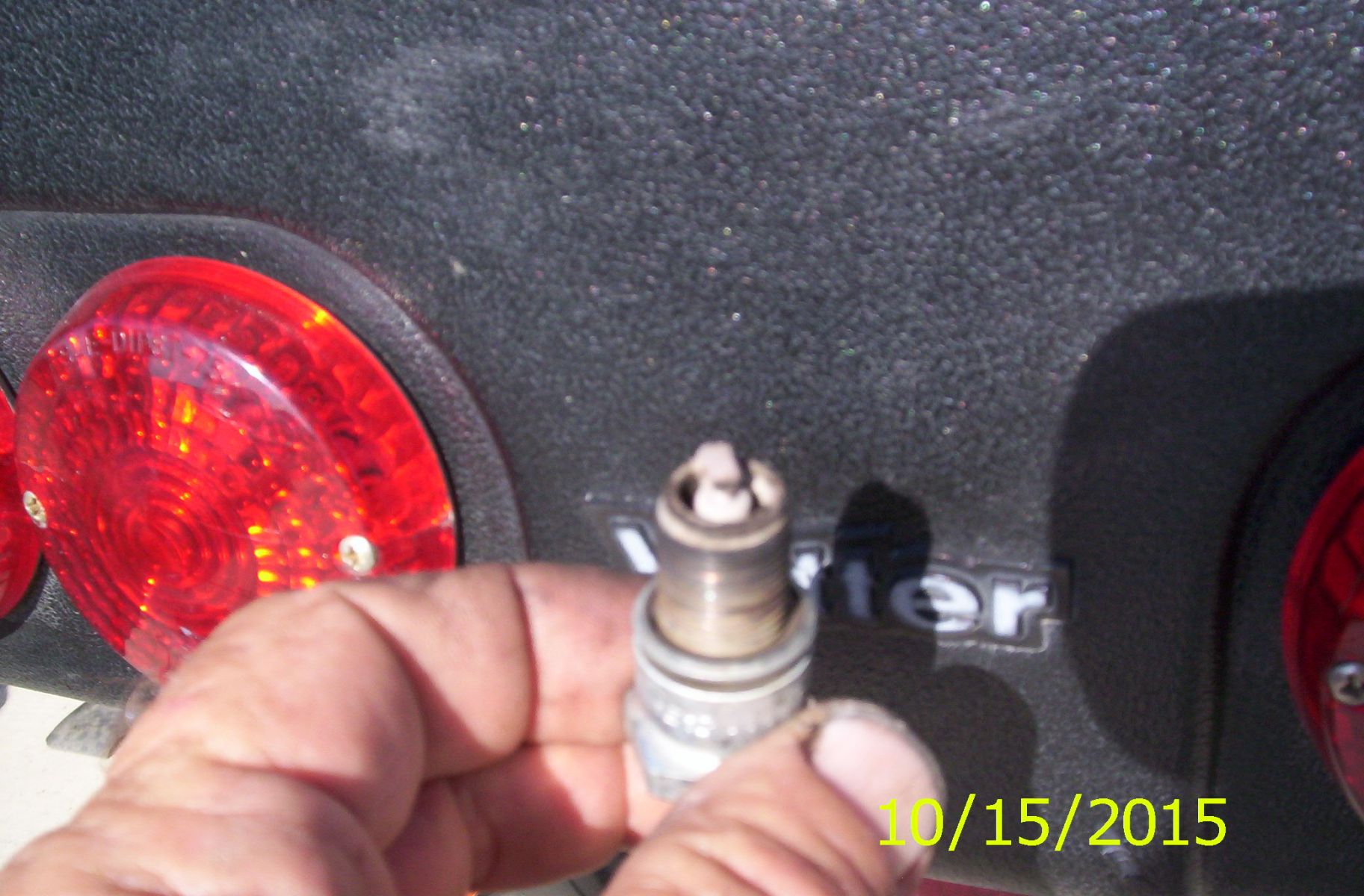

Storm came through lats night. Looks like there's a hole I can get through and am heading for home. I took a pic of one plug. I had them peanut butter color before, so now that's my goal. ;)
This is the reaction I was talking about with the paint. CRAP.
Not done yet. :whistle:
