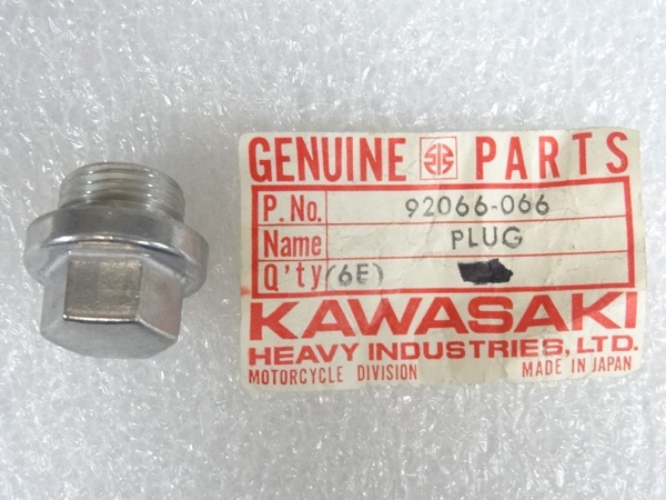

The oil cooler should connect to the engine in two places: on the right side below the ignition cover and on the left side below the stator cover (and I agree, on a 650 you don't need it).
On the 650s those two places originally had oil plugs, the OEM part no. is 92066-066,. Also each plug has an o-ring (18 mm), OEM part no. is 92055-1146.
As to where you can find them, I'm not sure since I'm in Europe, but these plugs are used on several models and shouldn't be hard to come by, wouldn't be surprised if a member here had a couple of spares.
Here's a pic of what the plugs look like:
And here's one of the right side plug, the other is directly opposite:

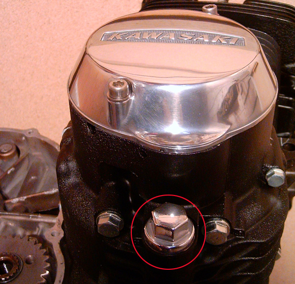

Oops, it appears that I was partially wrong in my previous post, sorry. The oil cooler does connect to the right side of the engine below the ignition cover (return), however the send is not connected below the stator cover but to the oil pan at the rear of the engine right beside the oil filter. Here's a link to installation instructions of a Lockhart type oil cooler on a 650:
kz650files.kz650.info/adobe/KZ650OilCooler.pdf
Anyway, the plug at the rear of the engine is the same as the ones I listed above.
