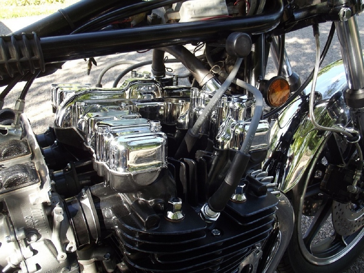

Is this acceptable?

Cylinders 2 & 3 are fired by the same coil, so the coil may be bad or there could be a bad connection to it, or the secondary wires may be cracked and broken.

TexasKZ wrote: That is very common. All you need is a hose that fits well. It is not causing your dead cylinders problem.
www.kzrider.com/forum/2-engine/599546-clean-air-system-delete
+1
I just capped them. check for leaky carb boots, good compression and make sure your valves are properly adjusted.

if your spark plug wires are long enough, you can try switching the wires from 2 & 3, with 1 & 4, & see if the problem moves to 1 & 4, but first get a proper size hose & clamps for the reed valves on the valve cover

Does it have to be beer? :laugh:swest wrote: I'd tack some beer can material or aluminum sheet, trace it out, cut it and put them under the caps for good measure.
