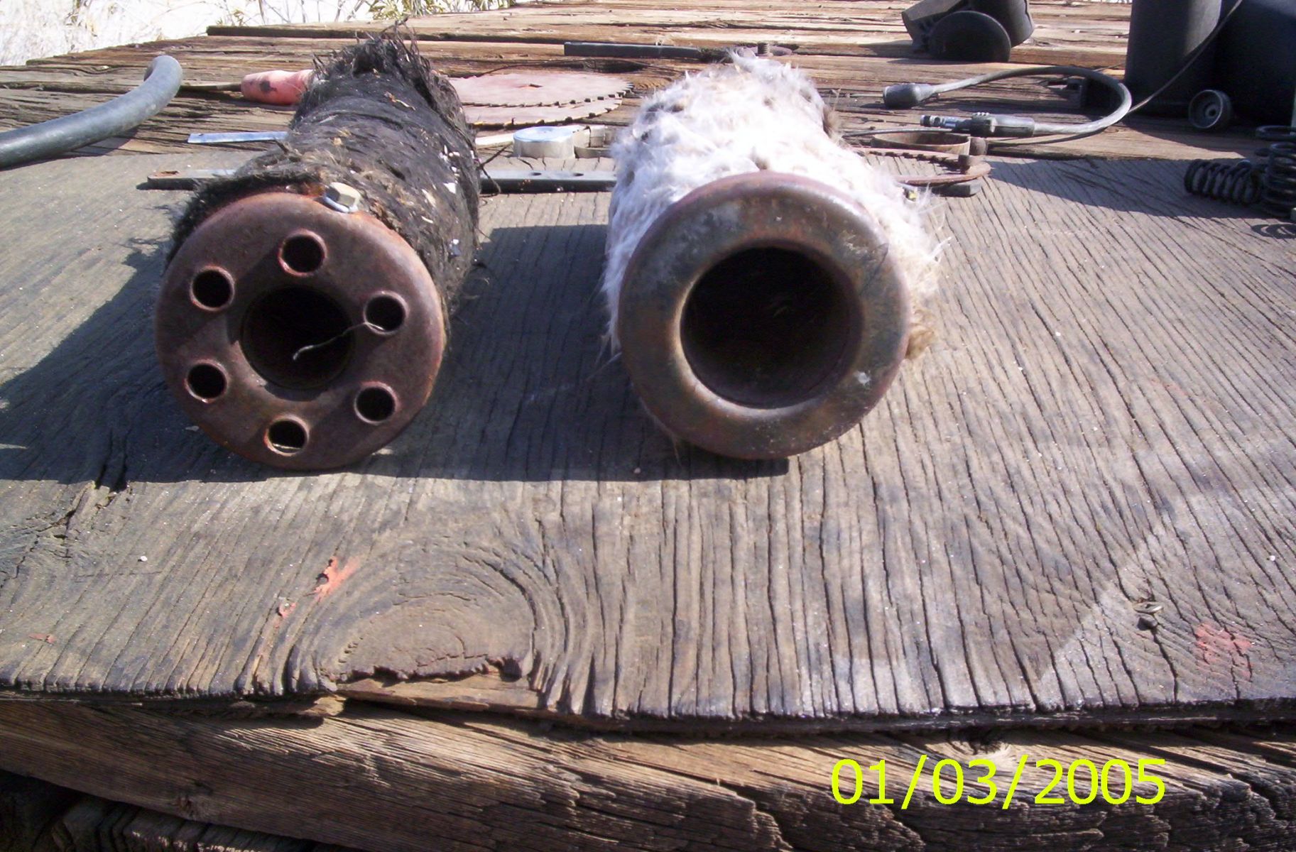

You can get the Comp baffle and have it both ways.

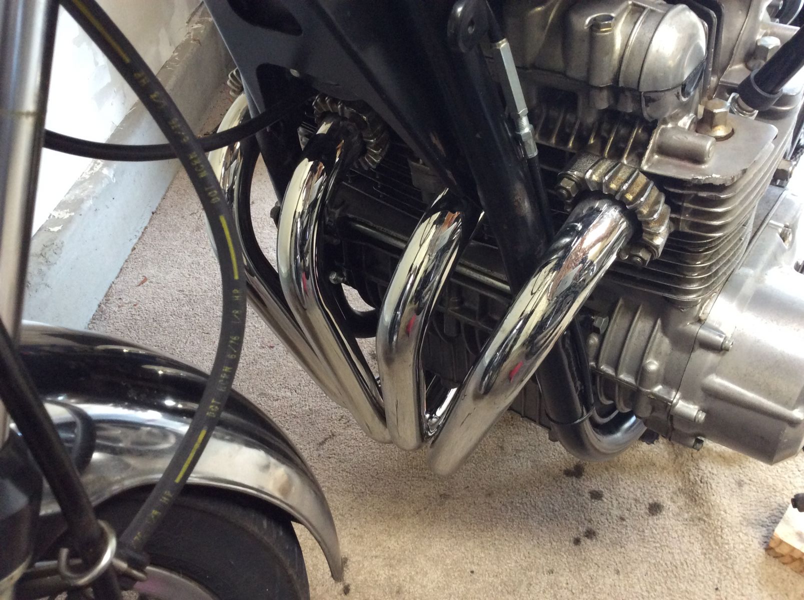

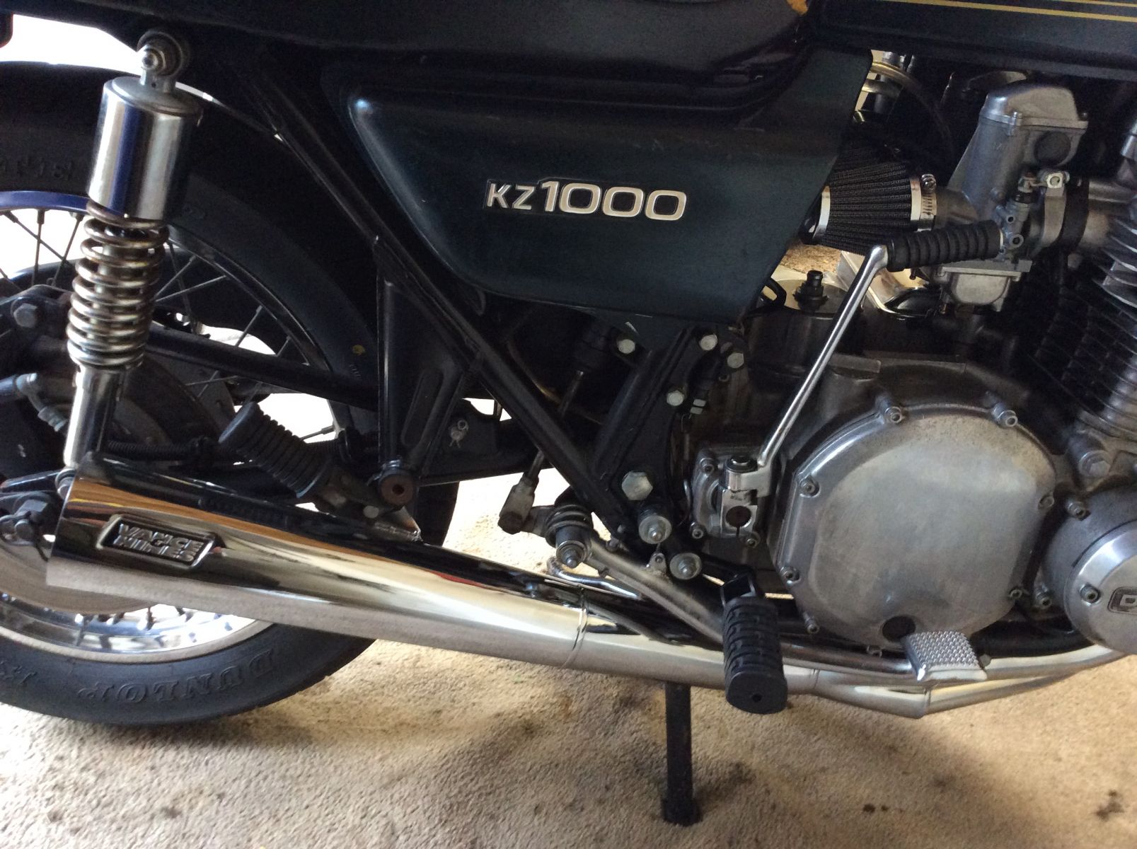

So got em mounted started with 1 1/4 turns out 17.5 pilot, 120 mains cheapo pods that came with bike, runs pretty great got good throttle response. So I'm happy for the moment lol! Fitment was ok easy install. Here's a few pics don't judge too much I'm just getting started with this bike. I love the 4cyl power ... Can't wait to get rid of that seat but just want to getter mech sound first
