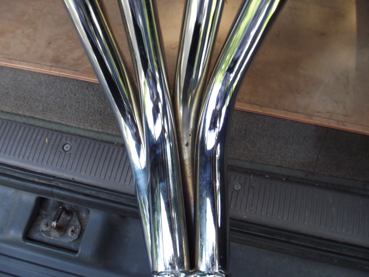

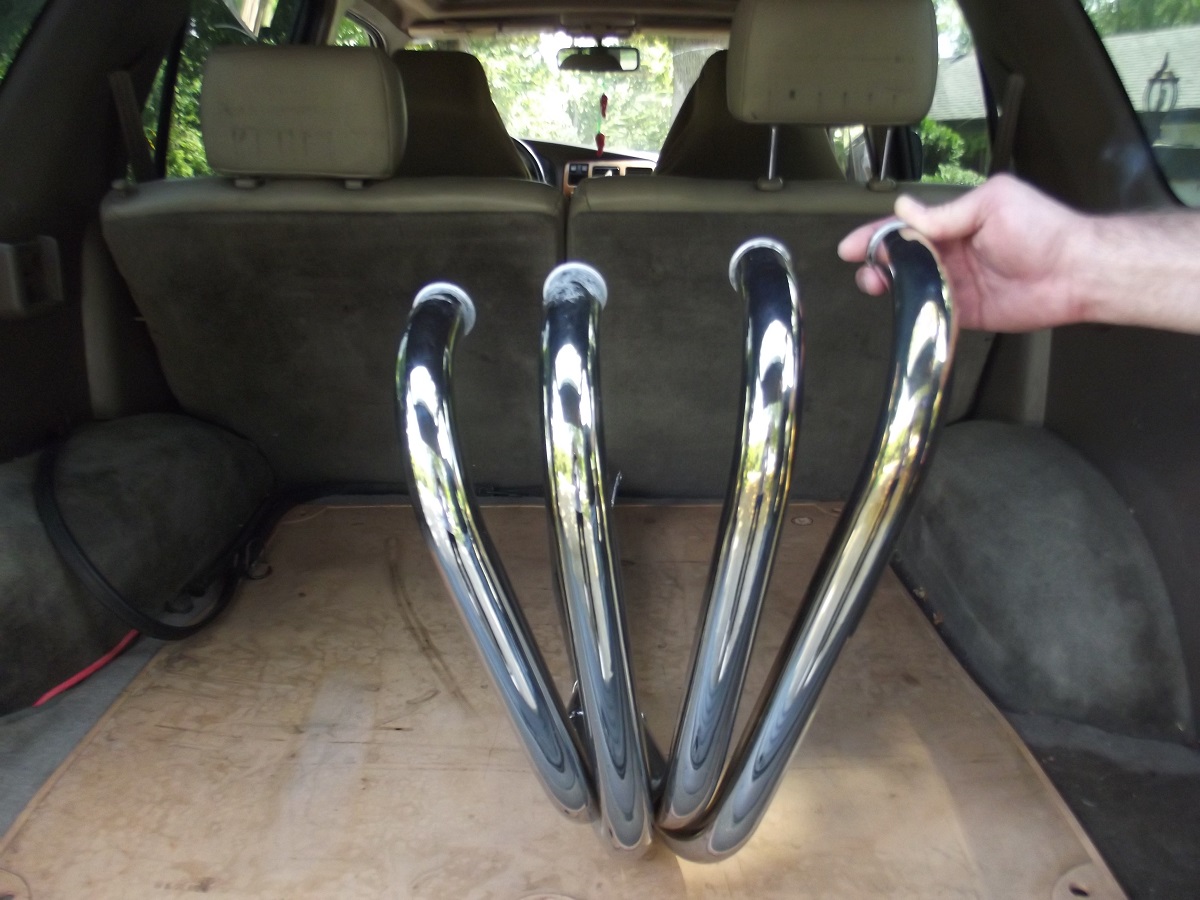

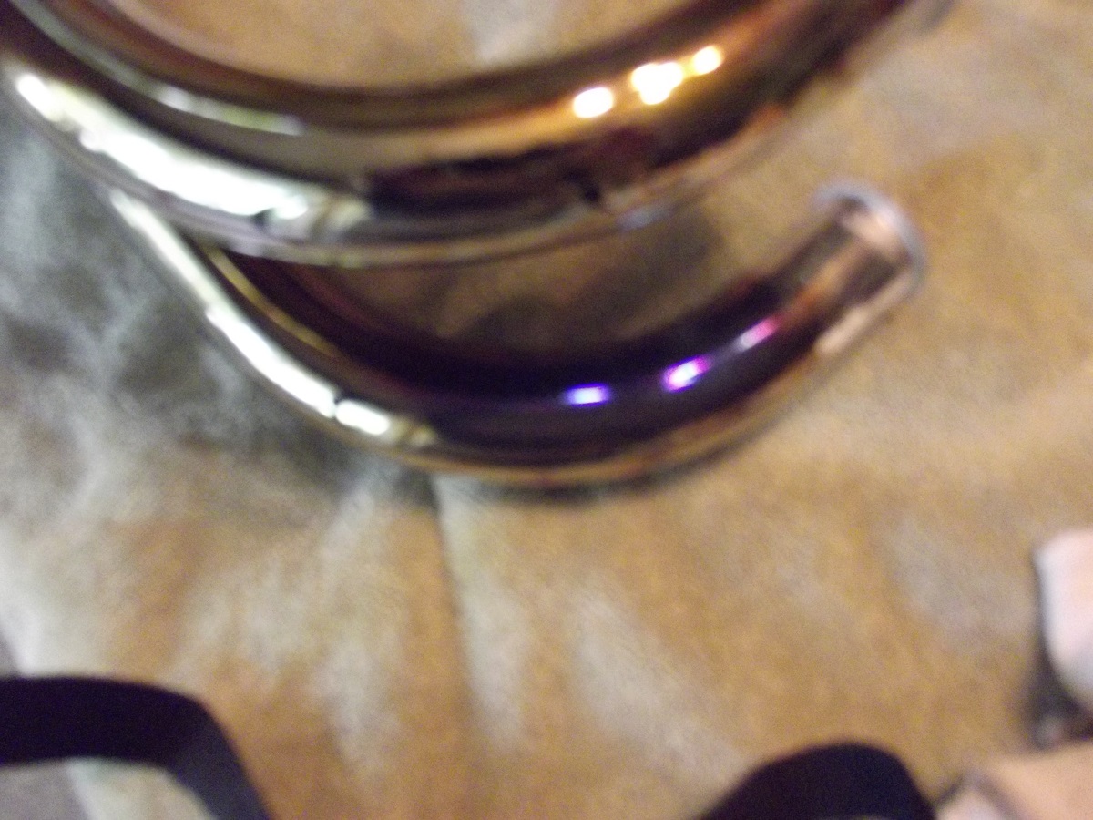

Not trying to throw any water on you fire, but as KZB2 650 mentioned, V/H don't make their pipes like they used to, the metal is very thin & the chrome plating as well, after 1 season of riding my pipes turned blue at the top & gold on the way down
I only got caught in the rain maybe twice, & noticed I was getting some surface rust at the collector
so when the season was over I removed them & bought some blue away or blue job & spent hrs. rubbing that stuff on to make the blue disappear, Patton had wrote an article about painting the insides of the pipes with 1500-2000 degree engine paint, so I wrapped & taped the pipes in plastic bags,& sprayed 3 heavy coats of paint over 3 days
I also notice that you have an after market clutch cable that doesn't have the metal spring thing to protect the cable sheathing from getting burned if it comes in contact with the pipe, so be careful of the way it's routed, you may want to get another cable clip to be safe
This is the OEM cable on my bike
because I painted the insides of the pipes, they still look like new after 3 yrs.

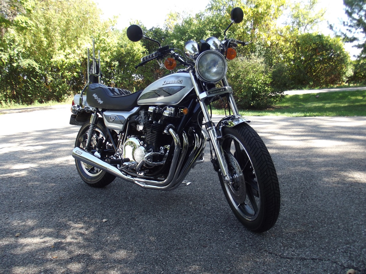

Heck, your whole bike looks like new, not just the pipes!! Very nice!! Ed
