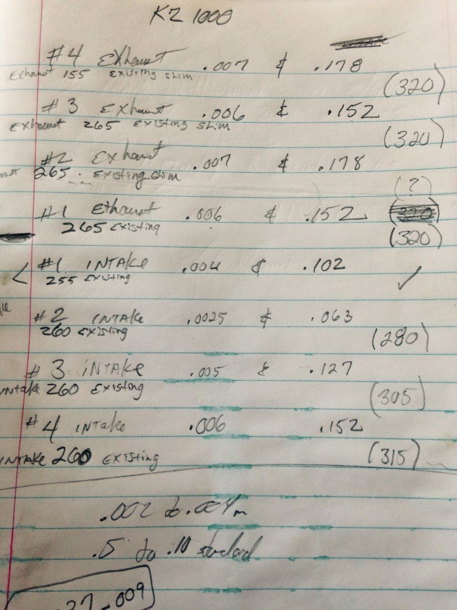

My exhaust valves were getting looser because I was burning oil. Bad valve guide seals. It ran fine on the carbon seats. :lol: Put in new valves and lost all my clearance.

Re: Stock cam lift?
17 Aug 2015 19:49
Just figured it out.....he was going by inches and matching it to the valve clearance chart on the left in mm.
Done
Thx all for the reply
