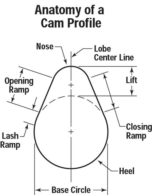

...He measured the cam lope and the it measure 362mm...
Umm, I think you mean 36.2 mm - 362 mm = 36.2 cm which is more than a foot long (1 foot = 304.8 mm/30.48 cm).
Is 362 the original cam lift?...
No, neither is 36.2. Measure the base circle, perpendicular to the lobe center line, then subtract that measure from the lobe heel-to-nose measure you already took (36.2 mm), the result is the lift.

I just checked a old Z1 900 cam and it measures 36.38mm from nose to base.

he has stock cams....Intake is 36.22 Exhaust is 35.55
so safe to assume that his cams are worn out at the base?
Or what else would cause loose valve clearances?
Normally valves get tight.

I just measured my extra set of KZ1000a cams, with about 15,000 miles on them:
Intake> 36.36mm x 28.30mm = 8.06mm lift, or .317"
Exhaust> 35.85mm x 28.18mm = 7.65mm lift, or .301"

17 Aug 2015 18:40spdygon wrote: ok
No, the base should not be worn out. Nothing rubs on the base (that's why clearance is measured at the base), so it should not wear at all. Of course, if the owner has the valves so tight that there is zero clearance all bets are off, but that does not sound like it is the case here.
Valves do not always get tighter. I have had them vary a little both tighter and looser. Ed
