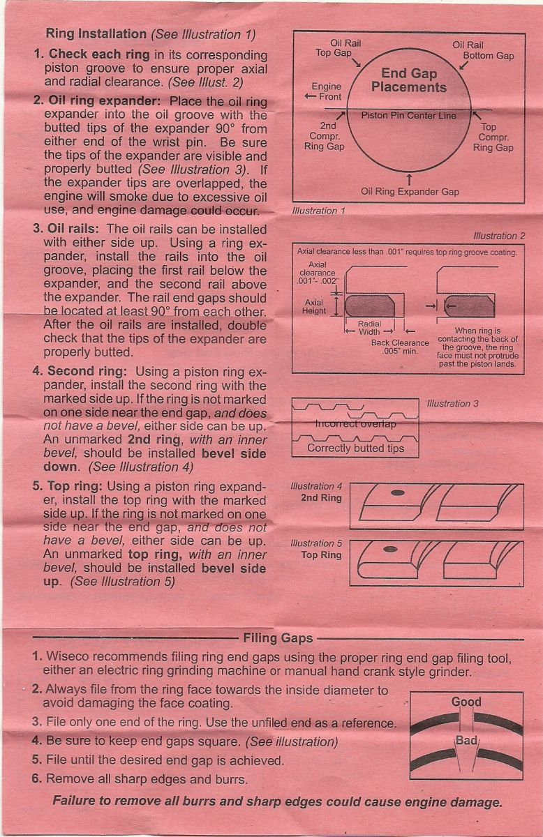

As stated before, the bores have to be true. If there is a ridge, chances are the bores are worn beyond service limits and or out of round. It is possable to "size" the bores by using a feeler gauge at the top, middle and bottom. If still within limits, I would use a block hone and new rings. I've heard of oversized rings being used but I haven't done it myself. If the bore is at the limit, the rings will be stressed that much more and can "walk around."
I set my rings as called for by the instructions. One more thing to take pics of while I install my Wiseco 10.25/1's.
Will be interesting to see how far they have moved in the last year and a half.

What causes the rings to rotate I think is the tangential load of the rings against the cross hatch hone pattern, like a bullet spinning out of a rifled barrel. The radial force is the combustion pressure pushing the rings hard against the bores. Some rings don't seem to rotate that much, although they are supposed to...7 rpm is the figure I've seen.
For a less than 1 minute task, setting the ring gaps just seems like good practice, if they rotate then little time wasted, but by staggering the gaps, if the rings are sticky it will minimise pressure loss through the ring gaps...that's the theory anyway. Also those first minutes of running time is critical for break in-which requires a strong radial force on the rings to bed them, gapping the rings evenly will maximise this.
