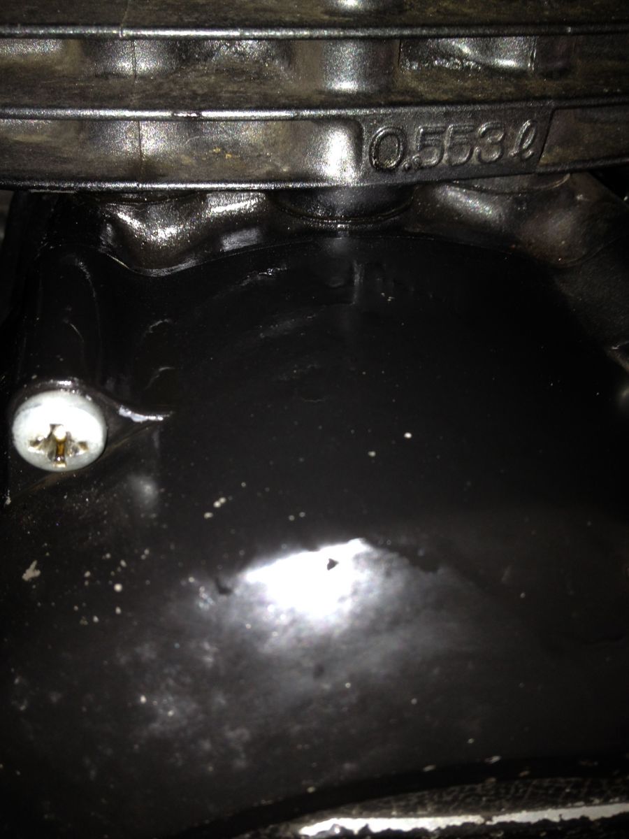

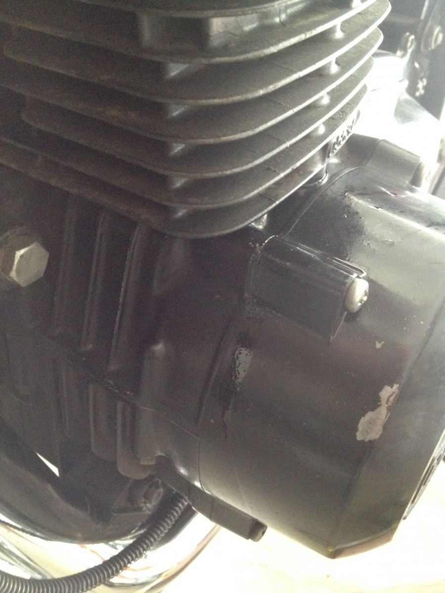

Hi All,
in a 100 mile ride I have to wipe the oil off of one side of the engine per photos. It seeps a little from the other side too, but barely. Seems to be coming from the base gasket near the front block stud or the similar looking boss that is not a stud just under the O553L in the casting. I am guessing this might be 'typical' for a 38K motor that has never been opened. Any first hand knowledge of an easy fix would be much appreciated. I am guessing I have 3 options:
1. Wipe regularly.
2. Re-torque head bolts after shooting a little carb cleaner into the joint to clean it and applying a wicking sealer (and possibly sacrificing chicken).
3. Replacing the base gasket (see #1 above).
Looking for some experienced GPZ550 advice. TIA,
Bill

Just did this last month on my 42,000 mile gpz550. You will want to replace the head, base and valve cover gaskets. Also, the four oil gallery O-rings. I also lapped the valves and replaced the valve guide seals. Also the tachometer gear guide oil seals. On mine, I replaced both of the camshaft chain tensioner springs and O-ring seal. For good measure, I also replaced the mission cover gasket and seals. Mine had good compression and did not use oil, so the piston rings were left alone. Any doubt of the rings on yours and would recommend replacing. On mine, the base gasket had completely disintegrated and was leaking the most. Good luck!

This is a common leakage area on the 550 mills. Re-tourquing the head cold, in sequence detailed in the service manual might help.
As above, if you are going to strip it then do a top end overhaul too whilst you are there. Oil leaks like this might not get any worse for some time if you want to leave it for a while.

That photo is really helpful. I'll bet my gasket/o-ring look identical. Any chance I can retorque just the outside bolts? What is the correct retorque procedure? Loosen all & retorque? Follow standard sequence loosen/torque in that pattern?
Tearing down the motor is not an option at this time, too many projects.
I am going to try come carb cleaner & wicking sealer. I will post results.

I just replaced all the gaskets in my 550 as well. Its unlikly it needs a retorque because there are only 3 bolts towards the center of the engine that holds the cylinders on. Its probably the o ring on the side of the block. The o ring is removed in this picture but you can see where it went around the oil jet things next to the #1 and #4 piston
