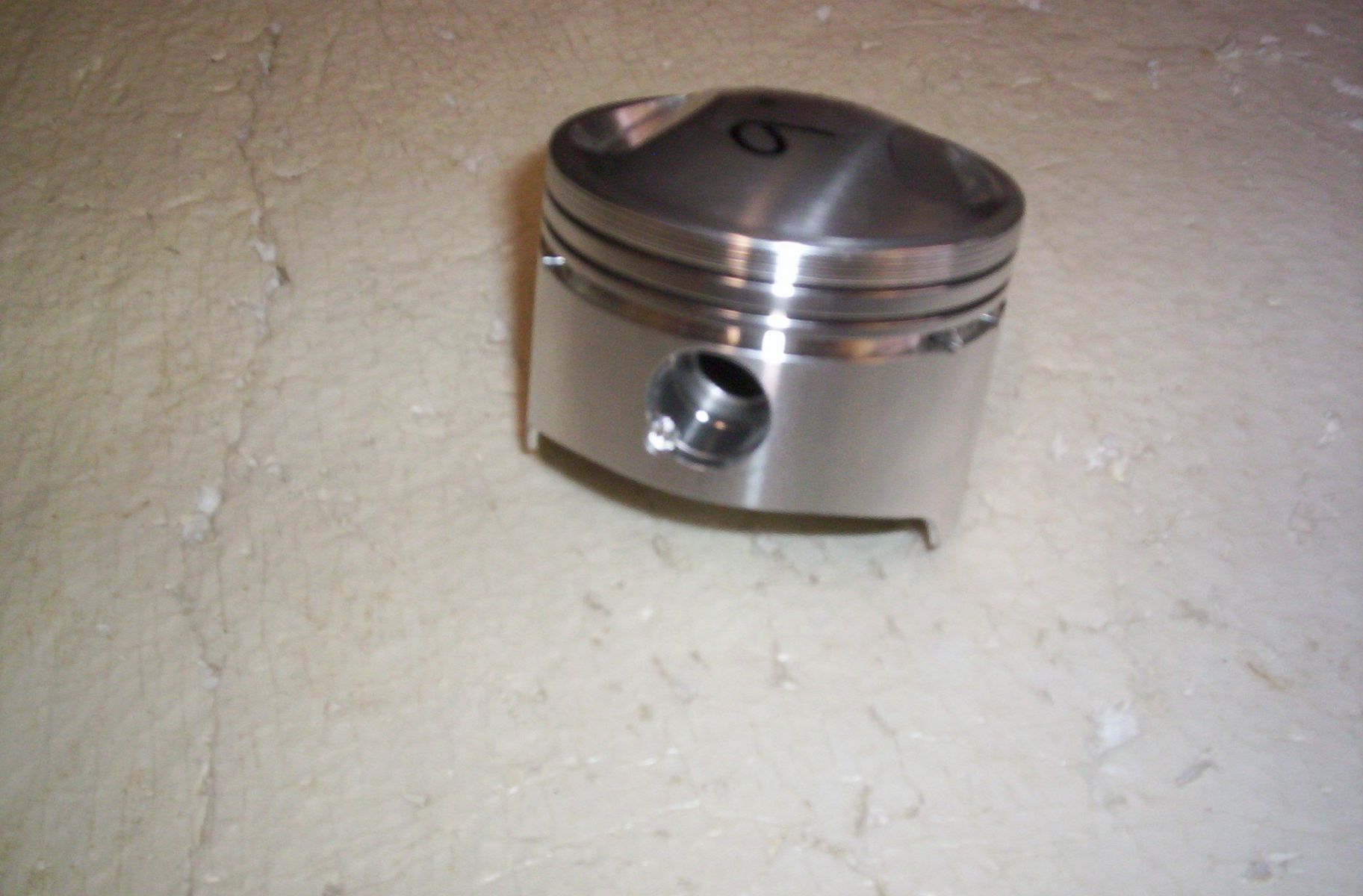

I've had these 72mm, 1075 pistons for MANY years waiting to figure out what I was going to do with them.
Actually bought them for my old KZ1000LTD.
I showed them to a local guy here today and he thinks they are really old and or doesn't think they are Wiseco... WHAT!??
They came in a Wiseco wrappings and box.
No numbers stamped on them anywhere but the supplied rings and the new Wiseco ring sets I bought last year, 2835XC, fit the lands piston perfectly.
I can't find any other info.
I did find the Spiral Lox clips here in Denver and they do look like they are the right thing for these pistons.

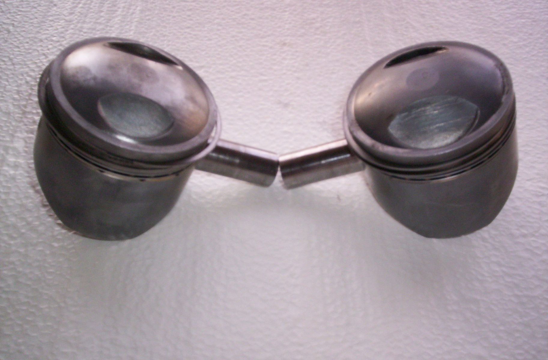

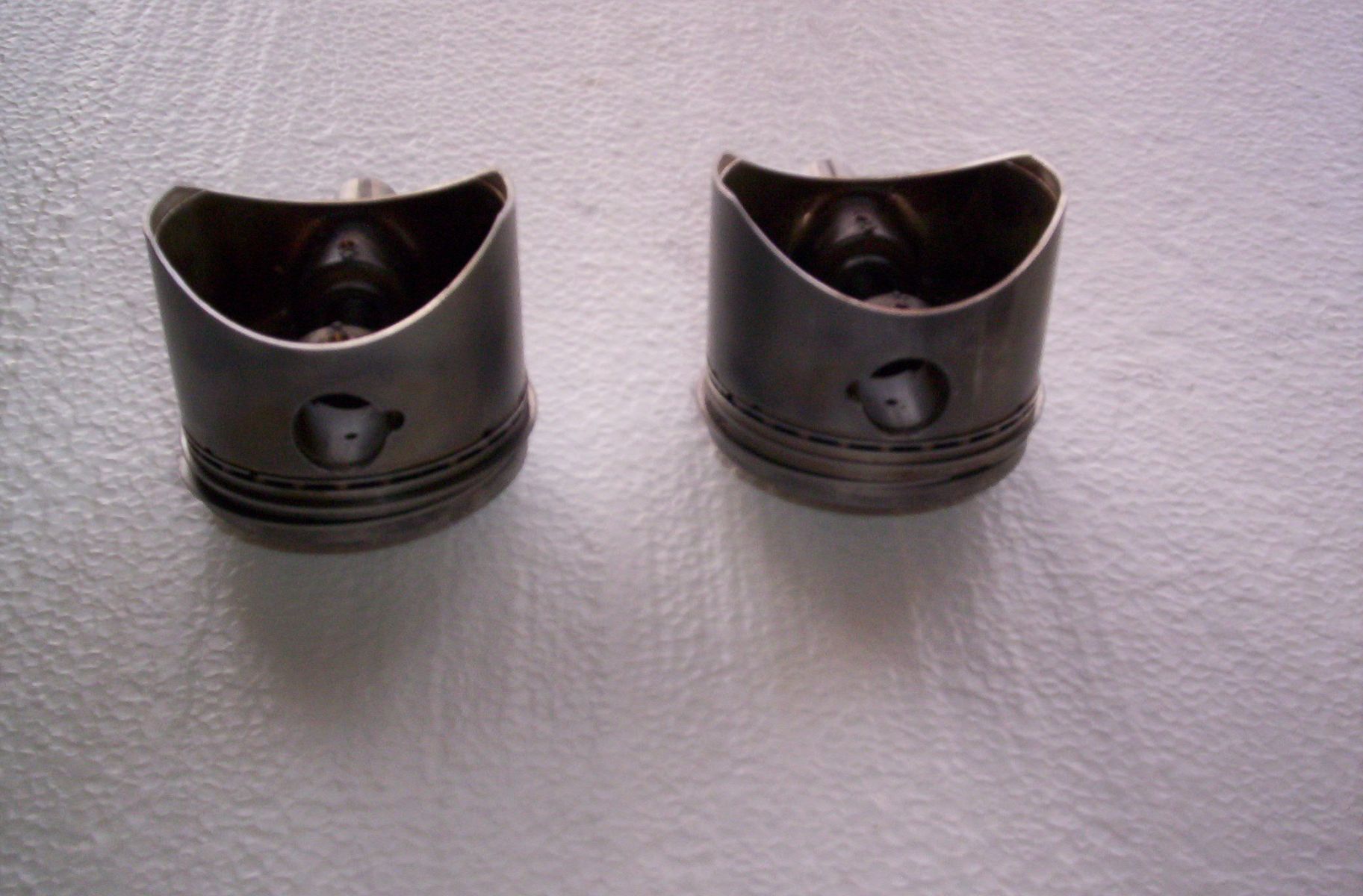

My old wiseco 1015 pistons look like that. I'd put them in using the stock clips. The wrist pins seem to stick in the piston and not the rod. I don't think you'll have any problems.

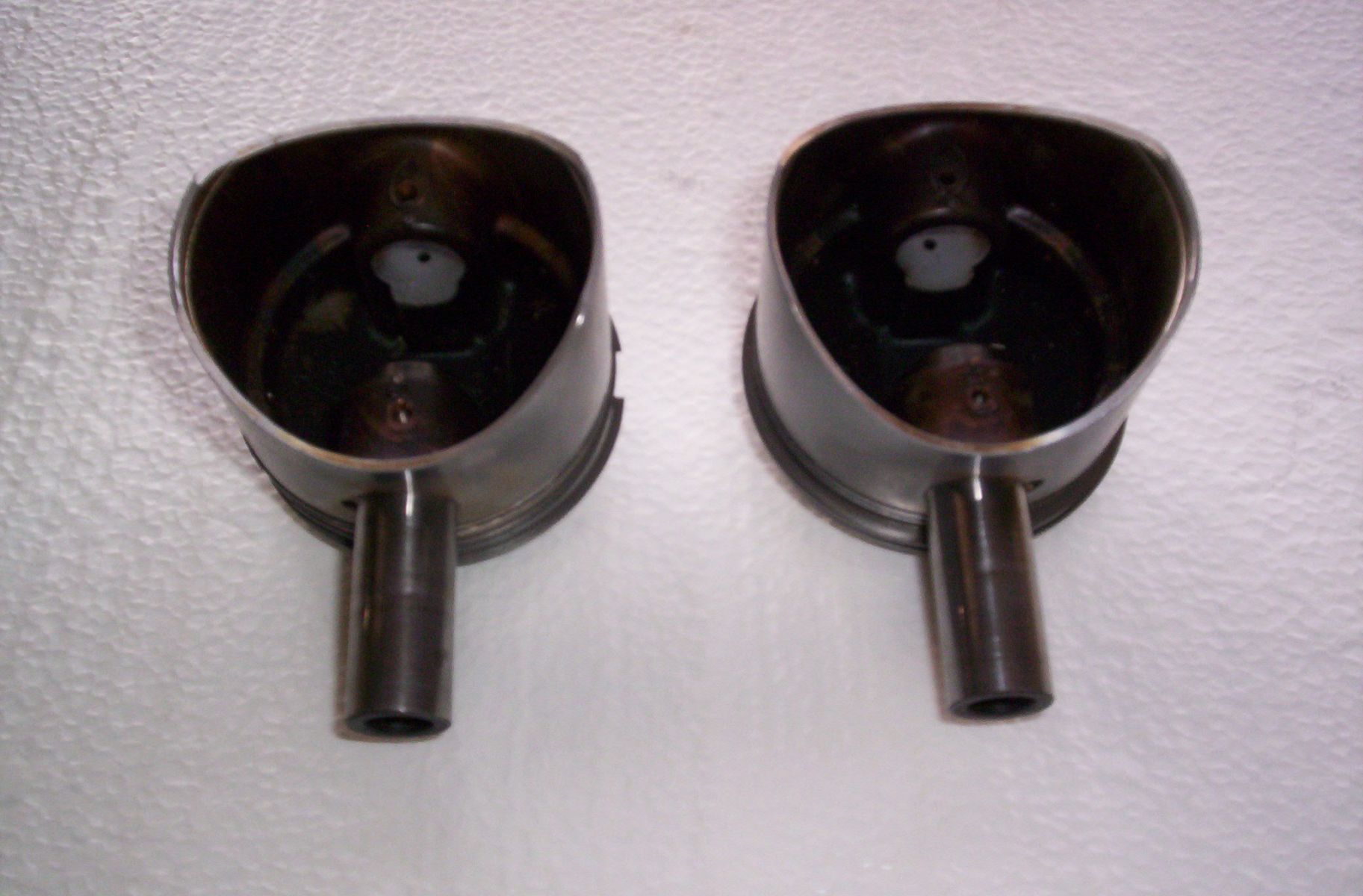

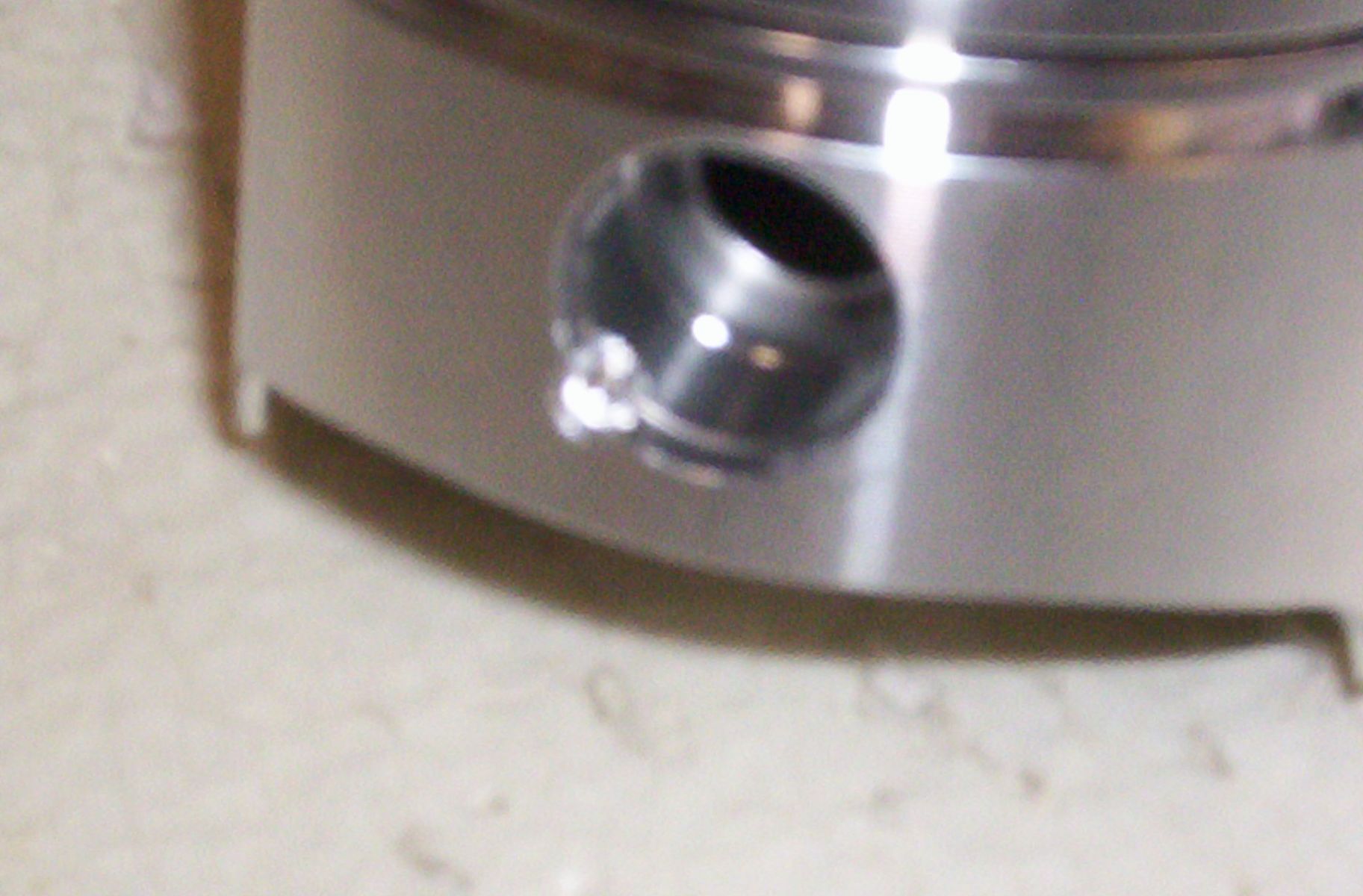

The obvious difference is that yours have a counter drilled hole in the skirt, by the pin boss so you can pick the clip out... mine don't.
Also, the channel bored in the pin bore to hold the clips is not round at the bottom on mine... it is rather flat looking.
Without that little hole to get a pick in, I had a devil of a time getting the original 1015 clip out of the 1075 piston after seeing if it would work....
I'd consider drilling a little relief hole in these (so I could get them in and out) and use the stock clip.... ?

I would. The hole goes just past the clip land. On the new style it is at the 5:00 position and the earlier style is at the 3:00. If it was tough to get them out, all the better. I thought I had found a used new style but the oil holes were bigger so I had to wait until I could buy a new one.
