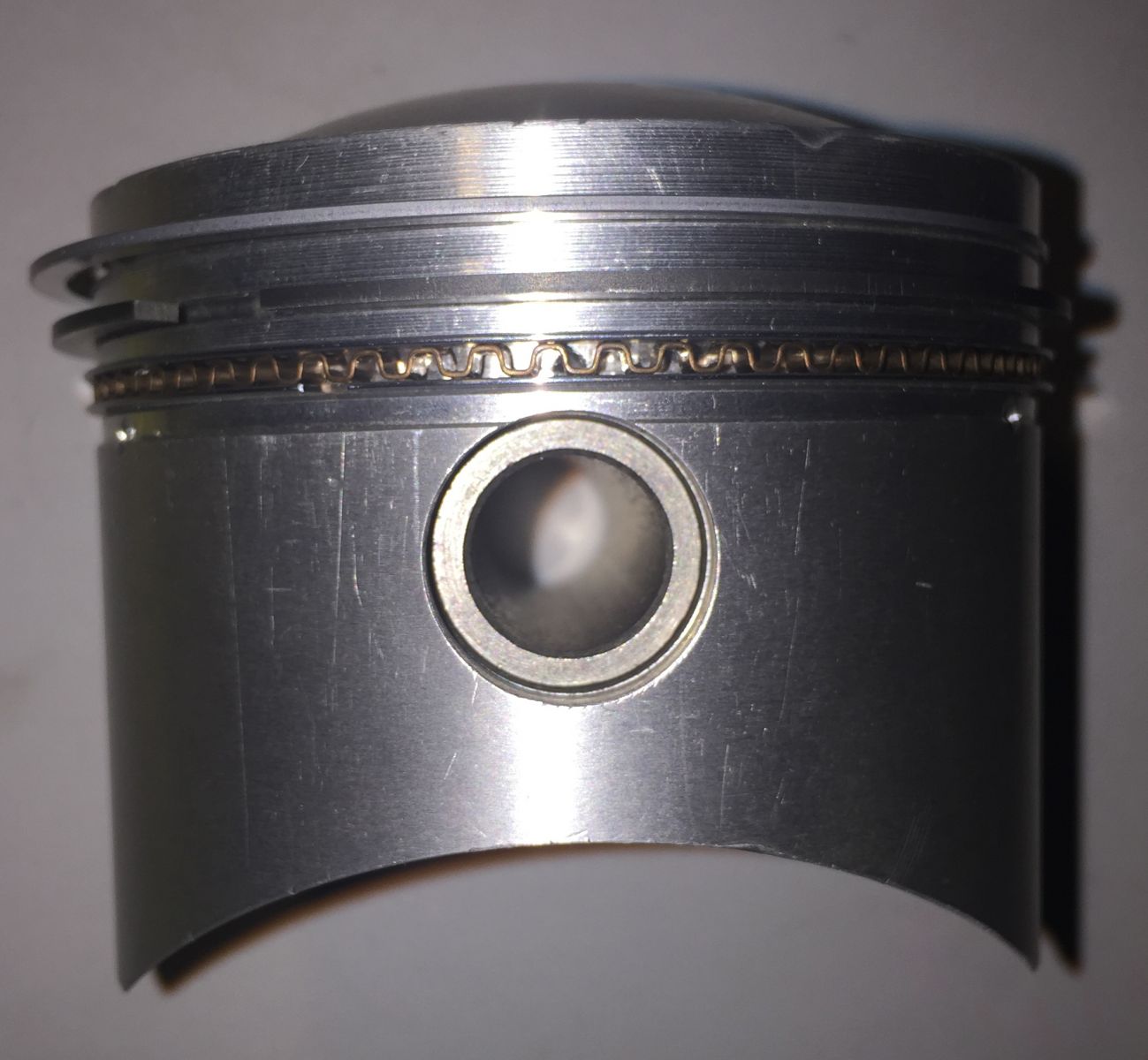

OK... I am wondering if the other guy is right and these pistons were and always have been made to use the Spiral Lox pin clips and not standard round wire ones?

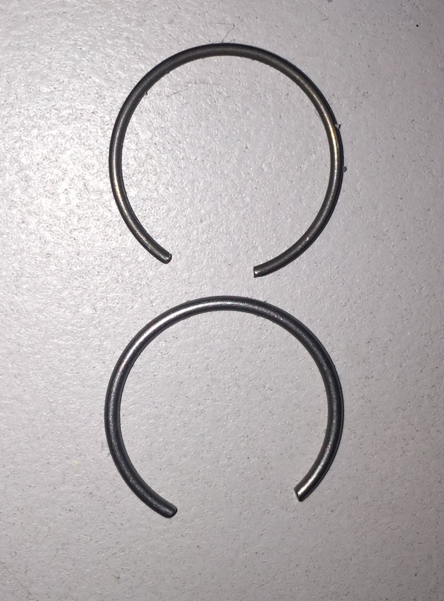

Below is the two clips, top is stock and does kind of fit in the Wiseco piston but the pin is loose.
Bottom is the Wiseco CW17... which will not fit in the Wiseco piston.
Below is the Wiseco piston and note, there is no relief to insert a tool to pull the clip out... making me think it does need the flat spring, Spiral Lox pin clip

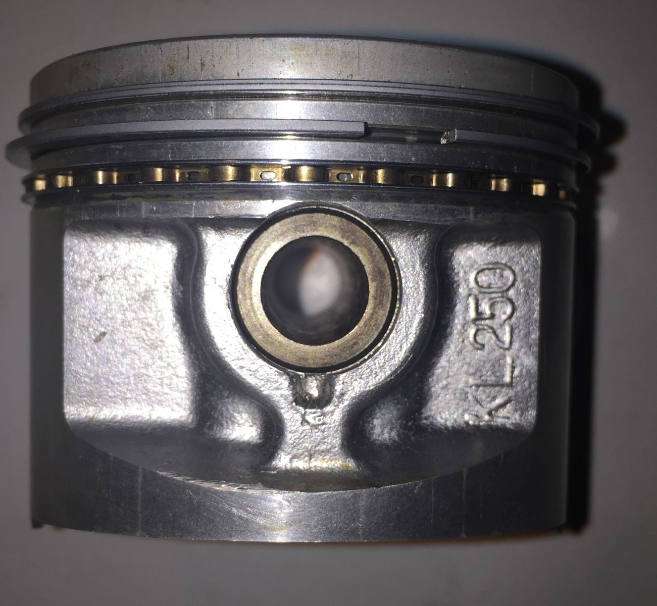

Below is the stock 1015 ART piston and we know it uses a standard clip and it does have a relief to insert a tool to pull the clip out...

That looks like a cast piston. My Wiseco piston has the cutout like the stock one. I measure 3.81mm at the bottom of the wrist pin to the outside of the piston. That is with the clip in and the wrist pin against it. I measure 4.13mm on the other side without the clip. Are you sure you have the right pins?
