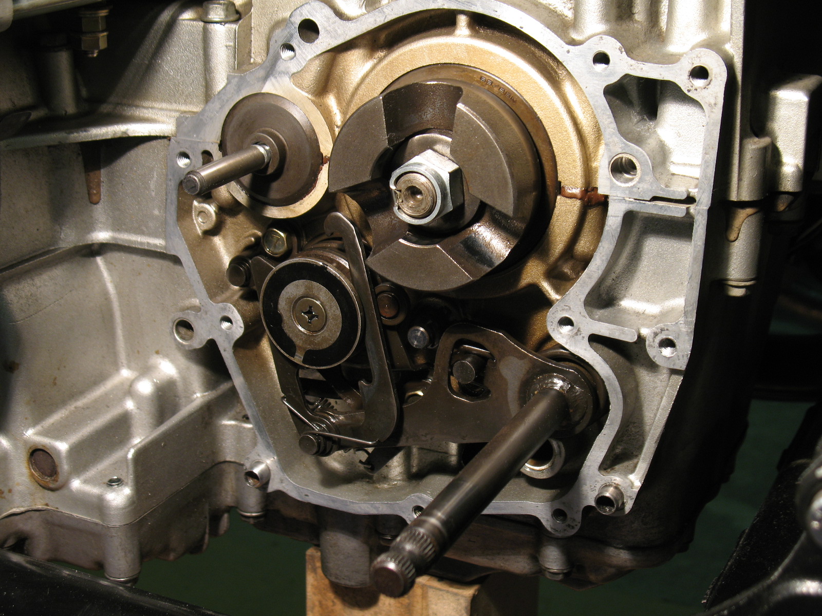

Pic (taken 2-23-15) added! Note how far the rod-end sticks out...that which broke off!!!

The last pic I posted reminds me how much effort lies ahead...again.
But I will ride...again soon.

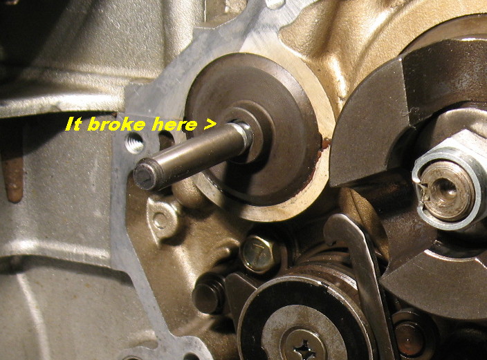

Looks like some kind of keeper spring just before it goes into the bearing cap? Is that where it broke?

25 Jul 2015 21:08swest wrote: Looks like some kind of keeper spring just before it goes into the bearing cap? Is that where it broke?
Damn.
Upper left...
