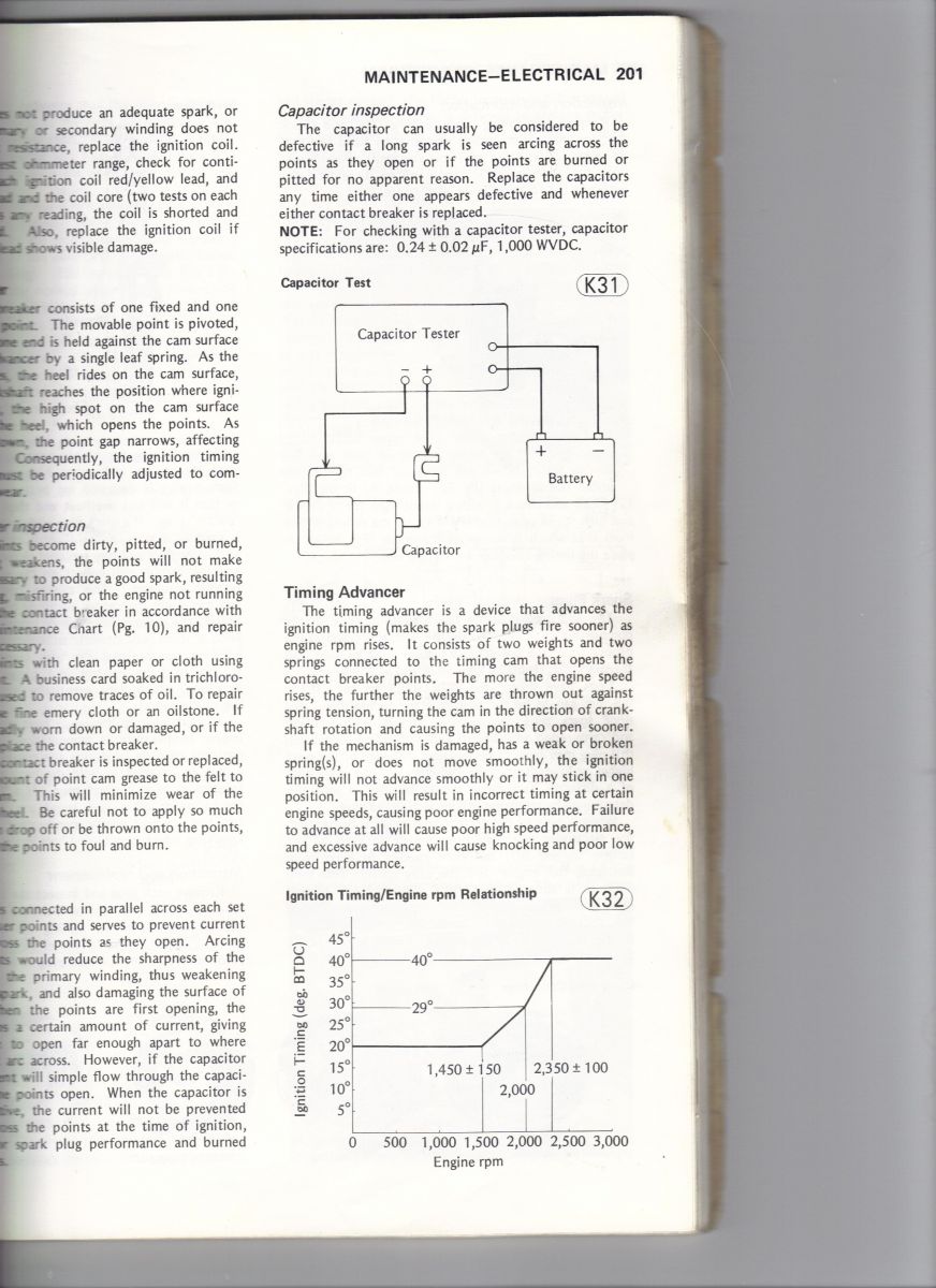

- Posts: 18564
- Thanks: 2103
Re: NOOB-1st Post, Timing Advance question
19 Jul 2015 09:10
Am thinking it doesn't matter to the advancer whether the ignition is points or electronic, so long as the advancer's F mark aligns with the case timing mark at idle rpm.
The advancer is of course a mechanical component, with no electrical function.
If the advancer springs are strong enough to hold the advancer in closed position at idle rpm, the engine may be correctly timed at idle rpm.
If the springs have weakened for whatever reason, the advancer with begin opening sooner as rpm is increased, thereby advancing the timing sooner at a lower rpm (a quicker advance curve).
For reference from the FSM for '77~'79 KZ1000:
Perhaps the poor performance at idle isn't due to the advancer, but may be resulting from clogged carb pilot circuits.
