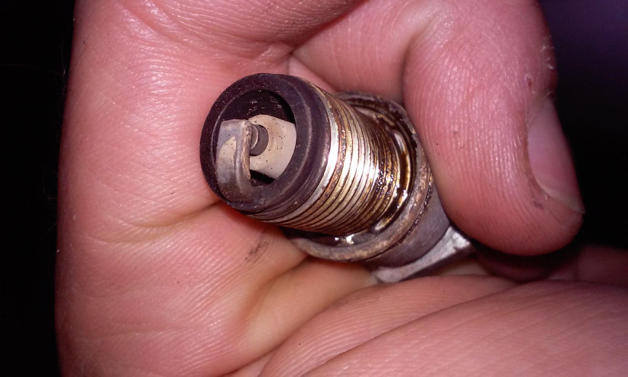

Cold is the heat range. B8ES is normal, B7ES is hotter, B9ES is colder. It's for compensating for hot or cold conditions. Running too hot? Put in a colder plug and so on.

- plugs look on the hot/lean side, adjust air mix 1/8-1/2 turn to rich. Not enough fuel could be causing the engine to choke up with throttle
