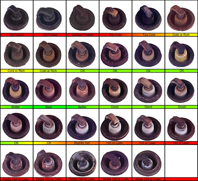

Look at your plugs. They tell a story. You havn't had the bike for long so a tune up is called for. If nothing else than to rule out things one by one. The valve adjustments are the most neglected parts of these bikes. Guys don't want to F with them because they take time, work and sometimes money. Once set, they will last for a few thousand miles or better. Once done you'll be glad you did, besides, like I always say, There's a certain satisfaction in knowing what's between your legs. :whistle:

What color am I looking for at the plugs?

Should be peanut butter tan. I started a thread on this with pics.
