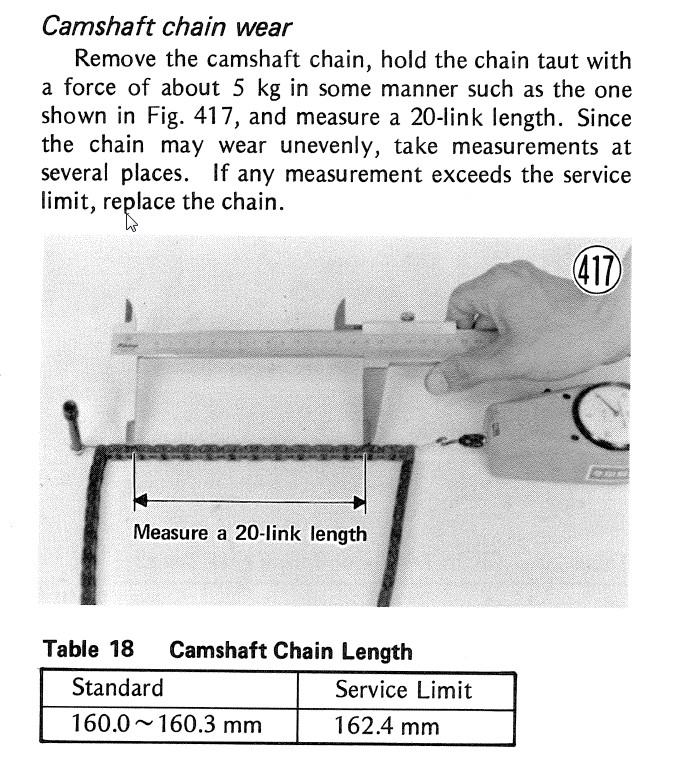

I also checked the ware and it was at 162+mm so right at the service limit. My grandpa says he stopped driving the bike when the timing got retarded and there was some chain slap. Believes it was coming from the cam chain, and that makes sense if it was at its service limit.
