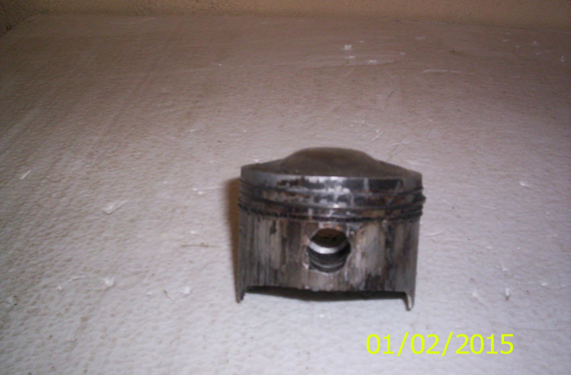

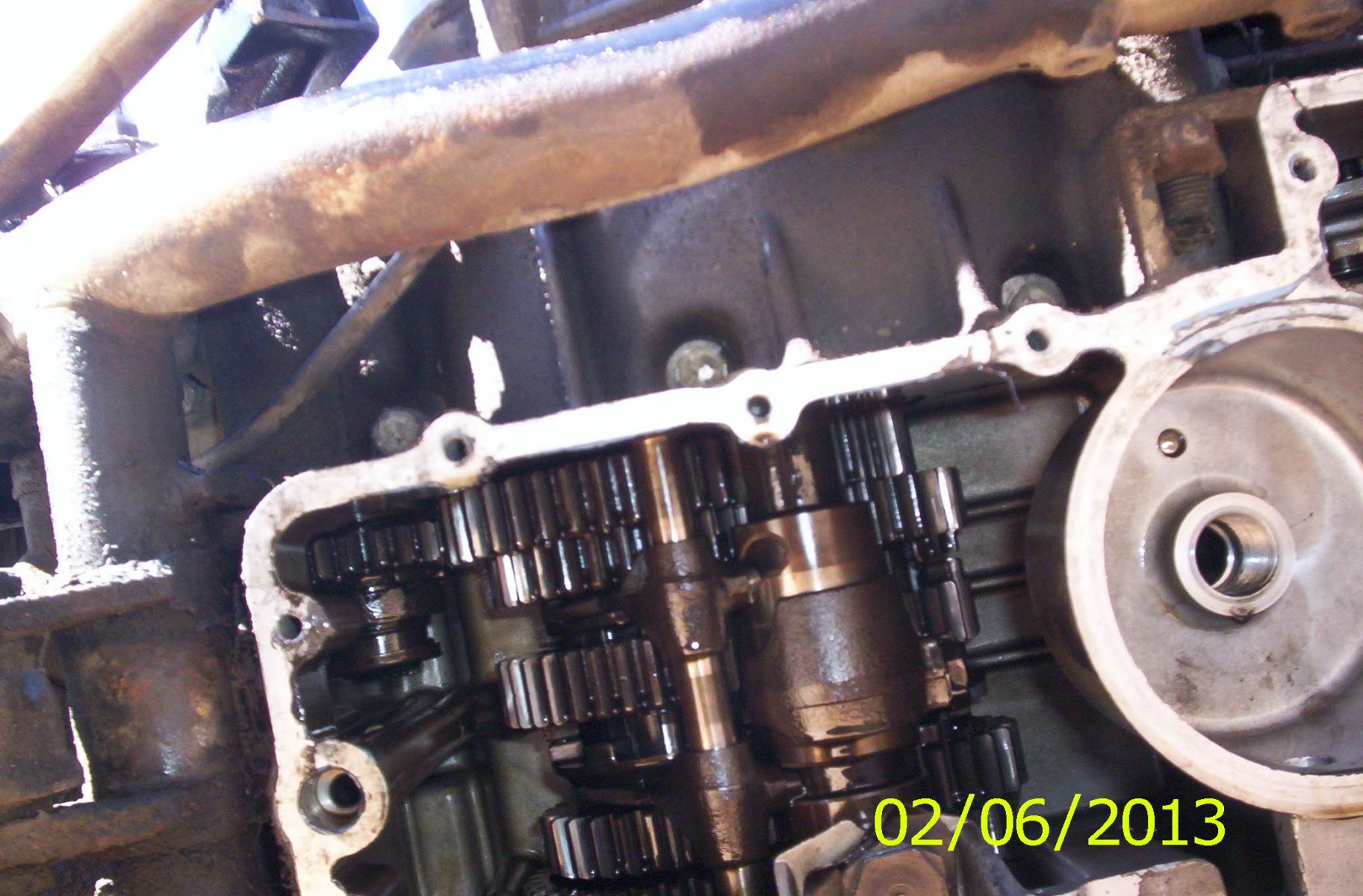

Might be sludge built up on the strainer. Try The Old Kaw Man on line. He has lots of oil pumps. I took two and made one. There are thinner gaskets as well to raise the oil pressure. First pull the pan and see if it is clogged. These engines are pretty tough. As ling as you shut it down right away and use good quality oil, you shouldn't have caused damage. The crank and transmission gets oil first, then the cams. The top end gets destroyed first. Guess how I know.
You'll have to remove the pipes to get to it and lay it on it's side on a block of wood resting on the alternator. If you take out all the bolts and bop it with a rubber mallet, you may be able to reuse the gasket. I use High Temp Copper silicon Let us know what you find and pics too.

Wow, now that's bad. :ohmy:
The oil pump gears are hardened and very tough. What goes wrong with them is small fragments of metal can score the aluminum faceings. To repair one of these, you can take #600 wet/dry paper on a sheet of glass and smooth out the wear marks. That's what I did plus matched the tightest gears I had. Cold start up it's at 20+ PSI then goes down to 3-4 PSI when hot. A lot of it has to do with the 20/50 oil I use. As the oil gets hot, it gets thinner.
