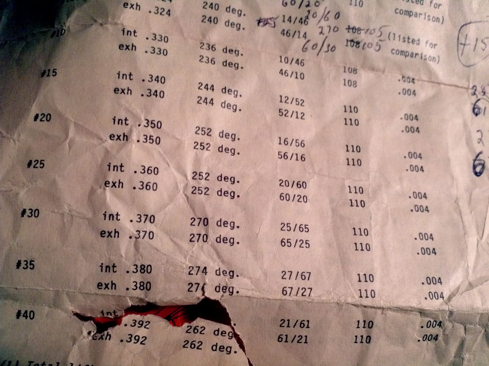

If you look at the chart, that's how they're marked. Maybe yours are different, I don't think so.

I Used some calipers to measure the lift on these and I'm getting .42 which seems like the 3X grind listed on the kz900 kz1000 chart and is not even close to anything on the kz650 kz750 chart i've attached below. Should I degree them to the 3x specs on the chart or is it a different ball game when working with a smaller displacement. Is it even advisable to run cams this aggressive in a 738cc set up?
