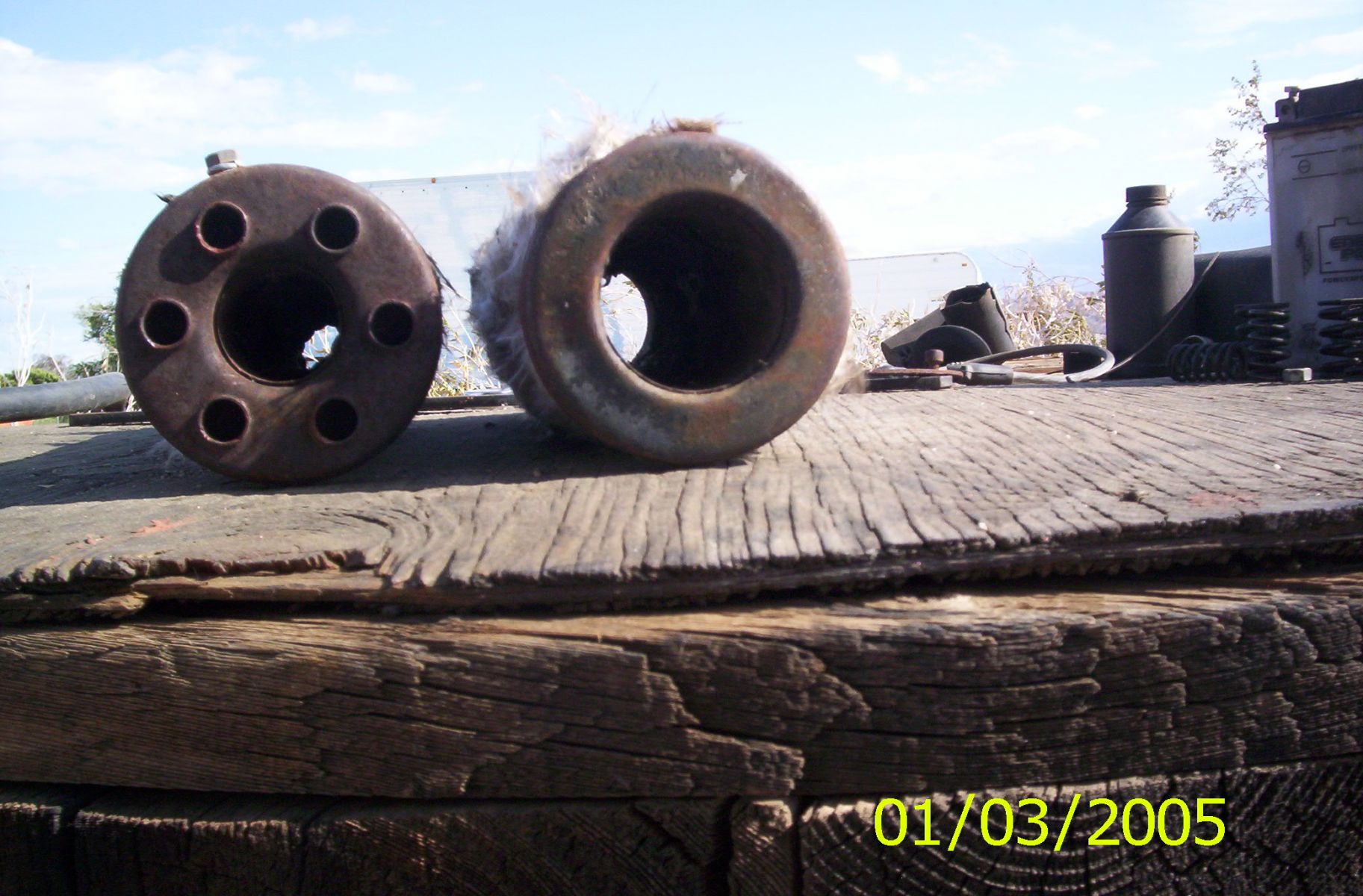

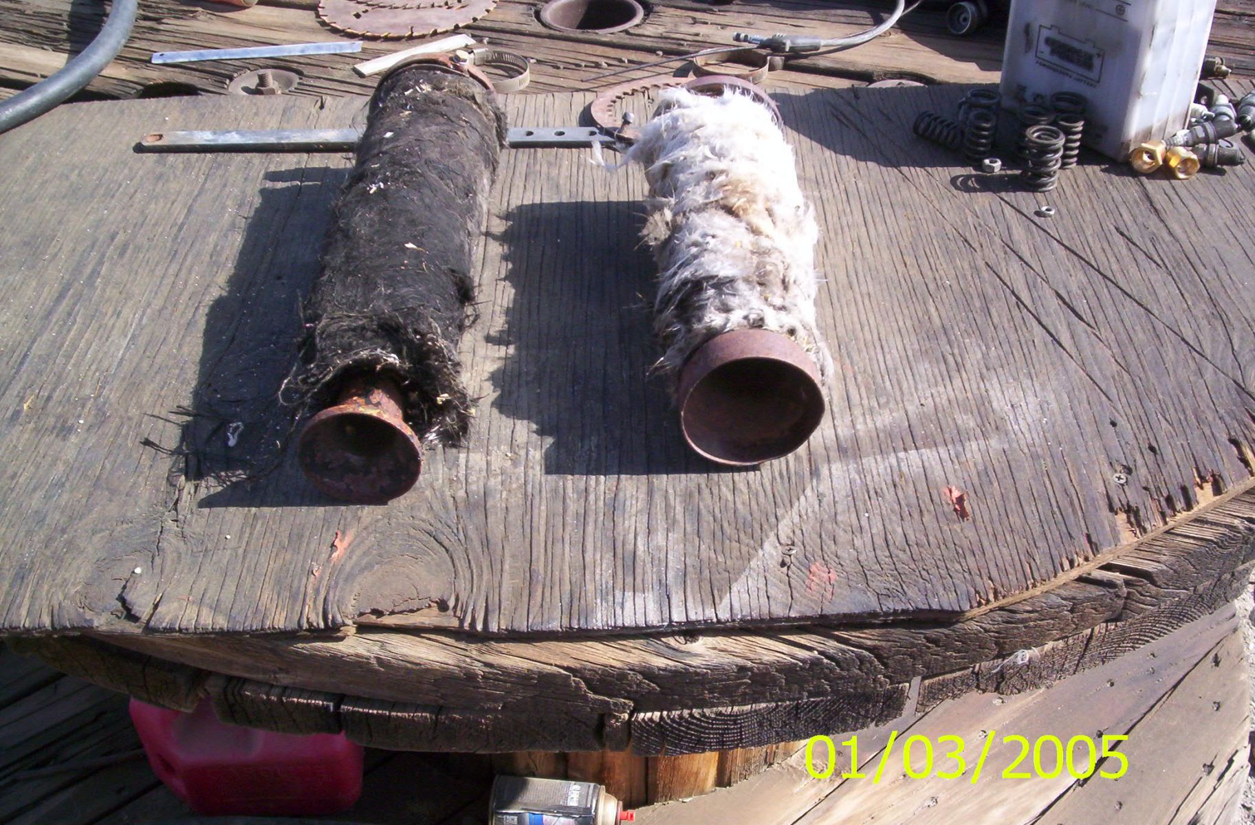

Try taking out the packing first. Here are the two. Stock and drag. I have the competition in it now. Turns heads every time and makes ponies with the packing still in.
Attachment Baffles001.jpg not found
Attachment Baffles002.jpg not found
Re: V&H Baffle modification
08 May 2015 16:48
Sorry, I didn't reset the date on my camera.

09 May 2015 19:08swest wrote: Sorry, I didn't reset the date on my camera.
No prob. Thanks for the pics. All the replies have pointed me in the right direction and now I can make a decision based on what info you all have given me. So I forgot to mention and didn't realize my used one actually had packing in it at one point. ( It wasn't there when I purchased it ). Which is just fine with me because the packing is out and it's too quiet for my liking. I'm gonna remove that backing plate at the exit behind the holes at the end of the baffle and see how I like that.
