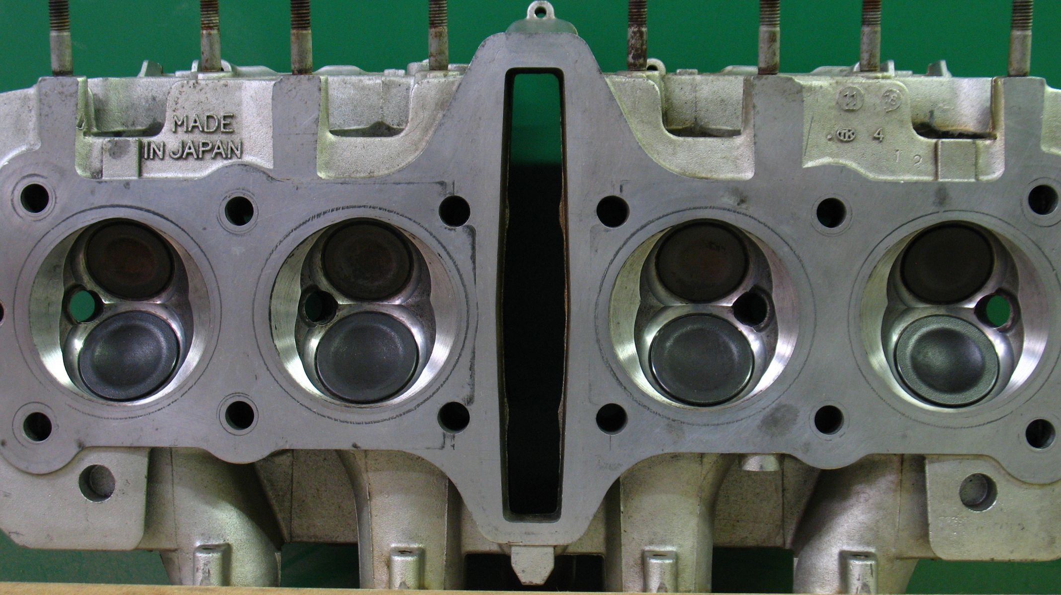

Thinking about using one of these?
1982 KZ1100-A2/1170 sleeper 😀

I am running an 82 GPz1100 engine bored to 1170 with 10.5-1 compression pistons, a WEB 119 grind a ported J head, Mikuni RS36 carbs, Kerker KR header and the stock oil cooler setup. Ugodly fast and absolute blast to ride. It is very streetable, I took it on a 3000 mile trip last year with no issues. Doesn't overheat and fine in traffic. With the setup you are thinking about you shouldn't any issues running it,
If it was my bike I would go ahead and install the APE valve springs and have the crank welded up while you have apart.
The head Daveo is talking about is off the 83, 84 and 85 GPz1100, the bathtub head. The 82 GPz1100 used the same head as the J model just with slightly higher lift cams.
