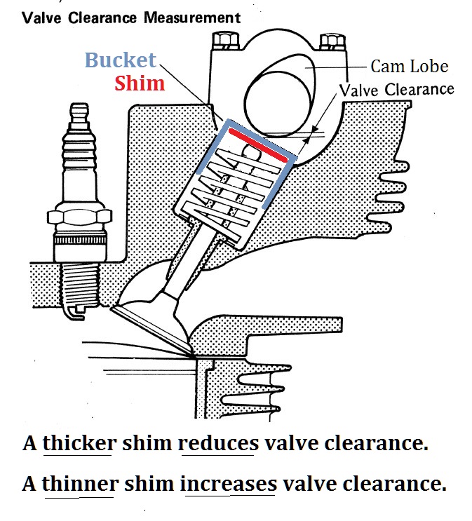

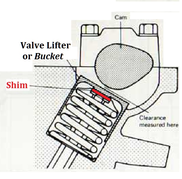

18 Apr 2015 06:44 - 18 Apr 2015 07:09The valve clearance is measured with a thickness gauge (sometimes referred to as a feeler gauge).
The shim size is supposed to be printed on one side of the shim.
If the size mark on the shim is illegible, the shim size may be measured with a micrometer.
