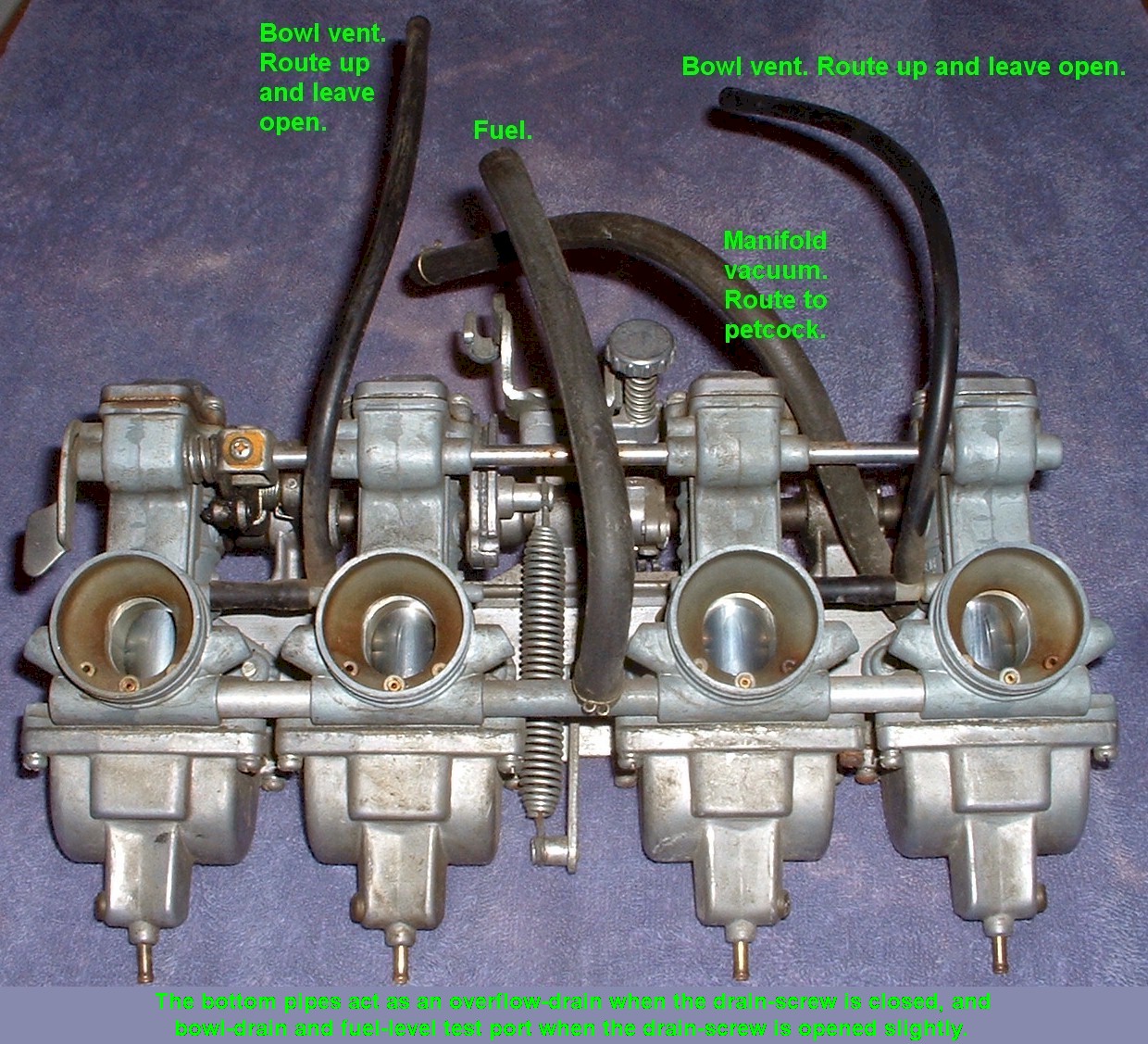

I got a couple stupid questions, most likely you covered these, but how do you know its getting fuel? did you check the fuel level in the carbs w/ a clear tube? Also, what about the 4 vacuum lines on the intake manifolds? are they capped and/or going to the emission device? Did you hook the fuel line and petcock vacuum lines up properly? What about the two vents for the float bowls? are they clear? I was looking at the pic you had in your other thread and I see a large white hose from the carbs, but do not see another - if you're using the fuel tank, you need to hook the vac line up from the carb (I think it comes off of #3) to the upper petcock barb and the fuel line goes to the lower one - the petcock will not pass fuel along unless they are both hooked up, or the petcock is in the prime position.

If you have the vents on the intake manifold open, along with the vacuum line meant for the petock open, you may be pulling in a crap ton of air and not much fuel... but I'd expect at least a sputter or cough from it.
If you can't use the tank, block all all the vac ports and take a small funnel or something and stuff it into the fuel line hose and put some gas in it.

here look at this. This is on lous goldmine site in is signature. The fuel line needs fuel. The line coming off #4 needs to be plugged or go to the petcock. The other two need to be open, hoses not needed for just testing purposes. the manifolds NEED to be plugged. Even if I pull a vac cap off mine while running it will chug badly on 3 pistons.
