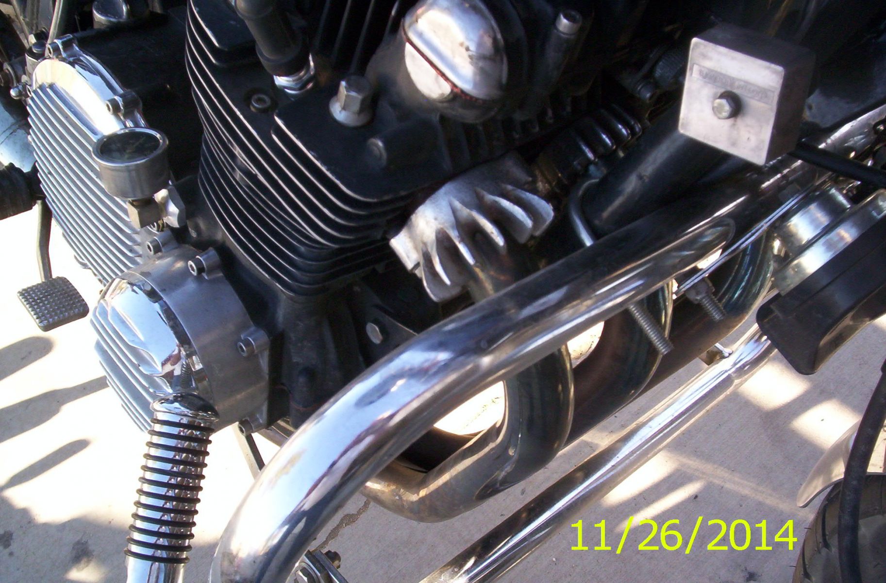

hello people; I'm new.I havn't done a valve adjustment myself and I do have one of those cheap tools but I might have to go for the better one. Witch one did you go with?
Do tell how it goes.
I like the black head.
