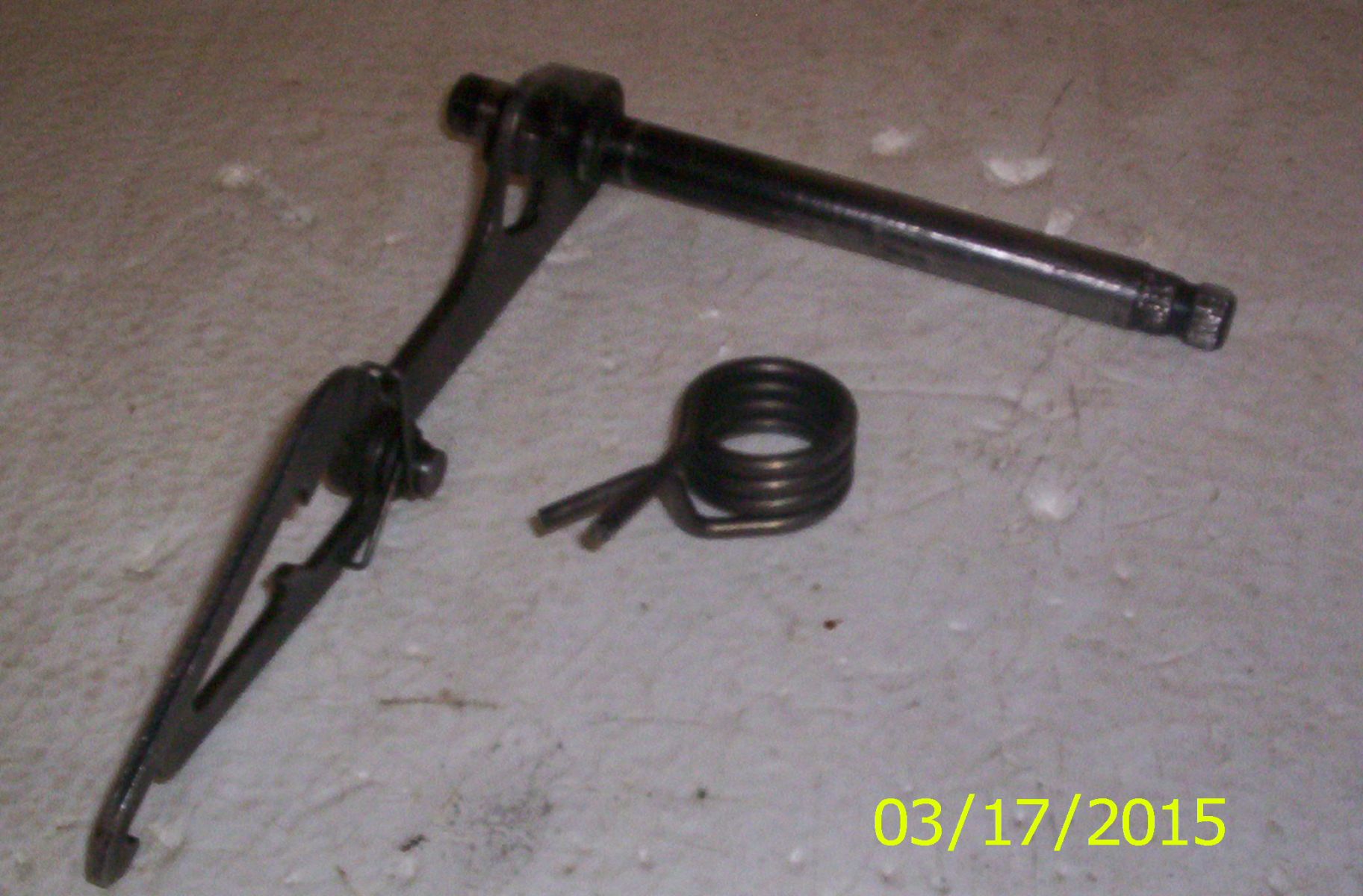

The clutch is the first and easiest to check. Check the adjustment at the cover and grease it. If that doesn't work and the cable is good, time to inspect the clutch plates. If they smell burned or are worn out, replace them. If still popping out of gear, open the clutch cover, remove the sprocket and take off the shifter cover. Might be a broken spring or springs.
If not, time to split the cases. 2 ND gear is the first to go. I back cut mine but it didn't last. There are two gears in play here. One on the counter shaft and the other on the primary shaft where the clutch basket is. If bought used, it's best to back cut them. They are worn and if not done, they will only last the expected life, no more and you're back to where you started from. Yeah you can just change the two gears, but the bearings and other gears will be just as old.
