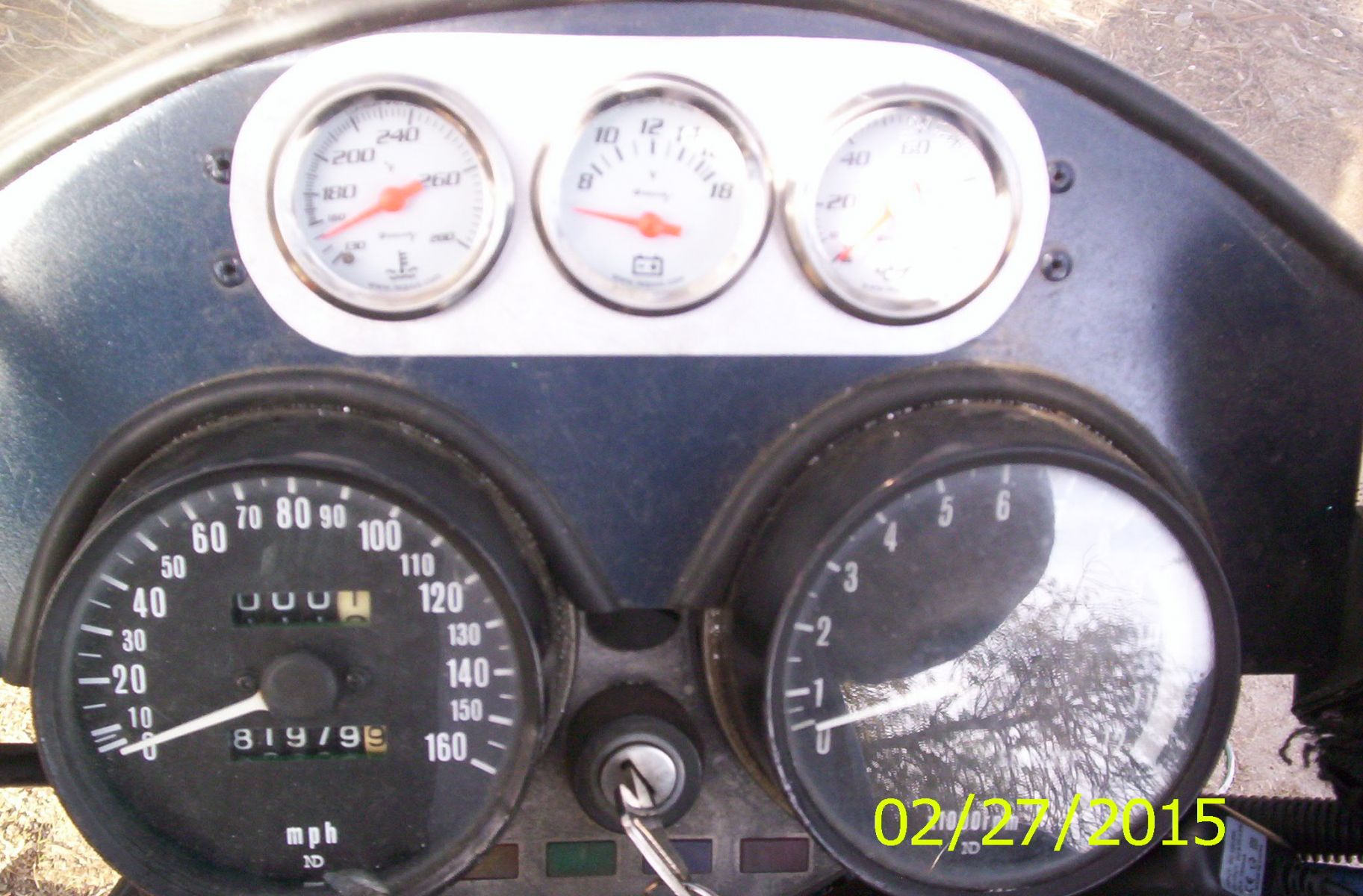

What does this temp gauge look like?

It was in the high 80's today and my temp. gauge read 247 F at 70 MPH coming up the grade to my place.
Sometimes when I shut it off it pegs.
