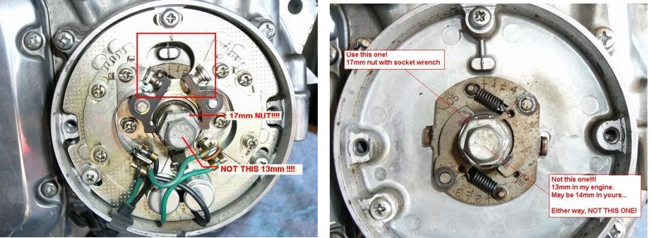

It is a centrifugal advancer, the ignition timing advances as the engine rpm increases. Later zx models had an electronc advance built into the ignition box. I had this problem before but it was jerky acceleration, but it is certainly worth checking.
Mark the position of the timing plate on the motor so you can put it back in the same position. Undo the 12mm, then the 17mm engine turning nut underneath it . The ATU advancer will lift off - it is located by a pin in the crankshaft so you can replace it in only the same position on the crankshaft. Step 4 in the factory manual is moving the counterweights against the springs so the rotating pointer lifts off. Give it a good clean with carb cleaner or similar, then lube it with copaslip or moly grease.

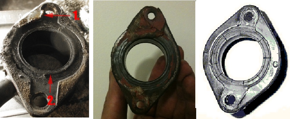

Won't hurt to try a temporary fix by coating the carb holders with three bond sealer or some less-worthy sealant. May endure for a week or so, at least long enough for test runs to determine whether or not carb holders are an issue.
One problem with pod filters is that the intake side of the carbs is unsupported, which stresses the carb holders and accelerates their demise.
Carb holders in this condition are pretty much DOA:
The advancer weight pivots are likely accessible for lubing through the timing inspection window.

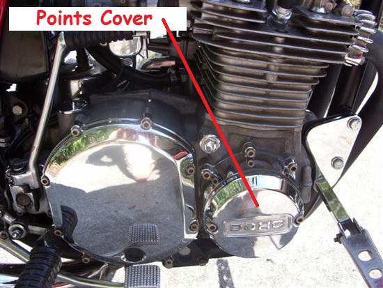

All this stuff is located under the points cover:
But sometimes more than just lubing is needed, especially if the advancer looks like this:
