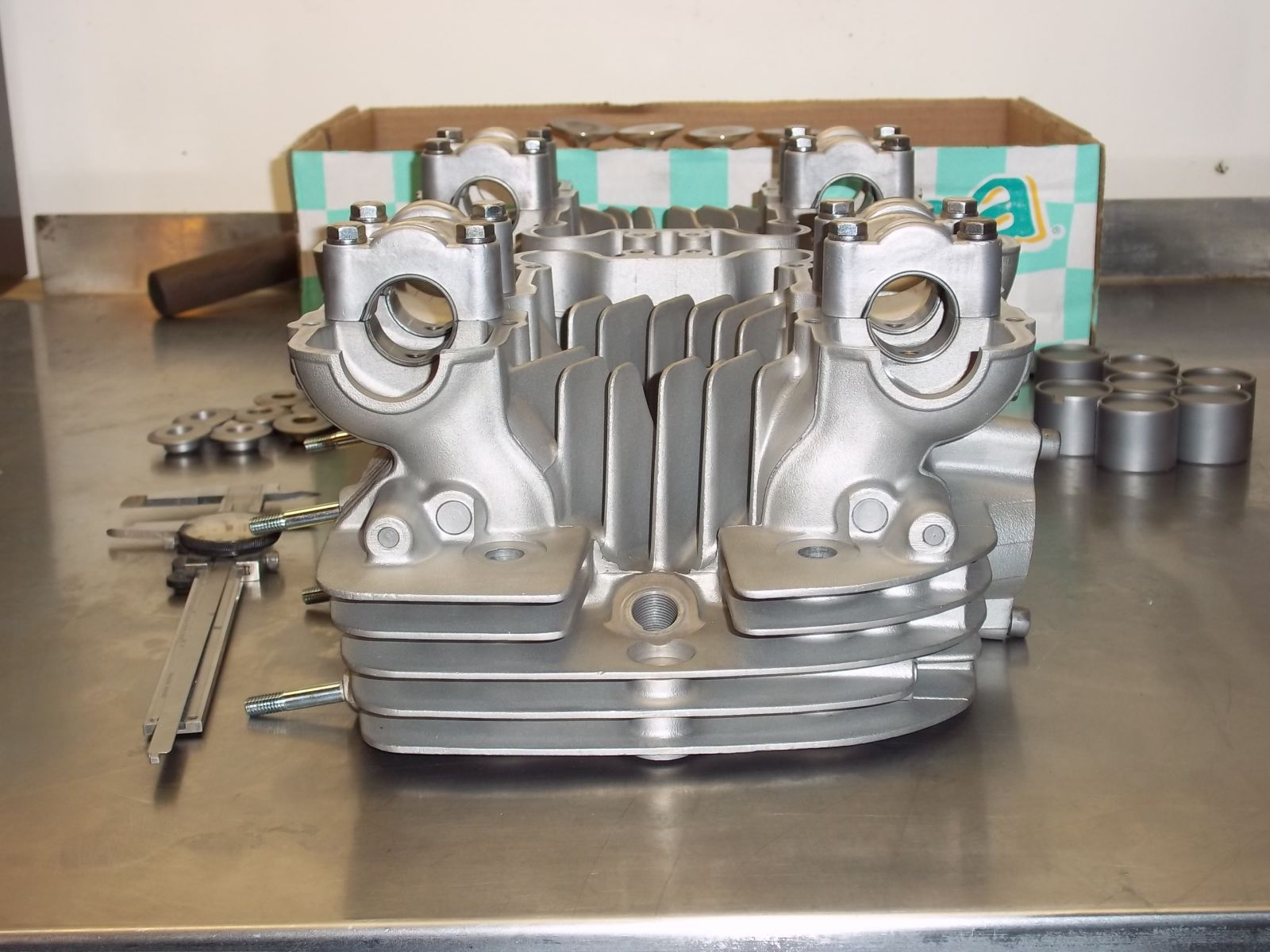

I glass bead Kaw engines apart. Trick is to hot tank, soak, agitate, totally get all oils and grease off 1st. before you do any blasting. I love glass bead. I have been doing it for 30 years on my own stuff and parts I sell on ebay.
I just did this old Z1 cylinder head.
Good Luck, let us see when you do this!

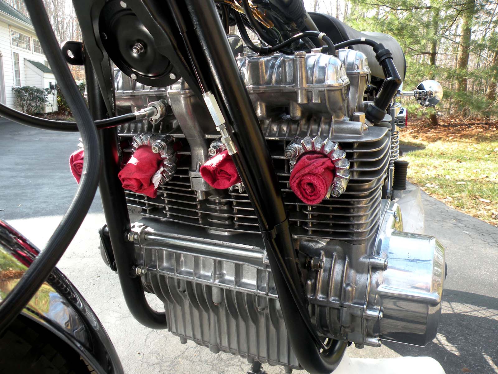

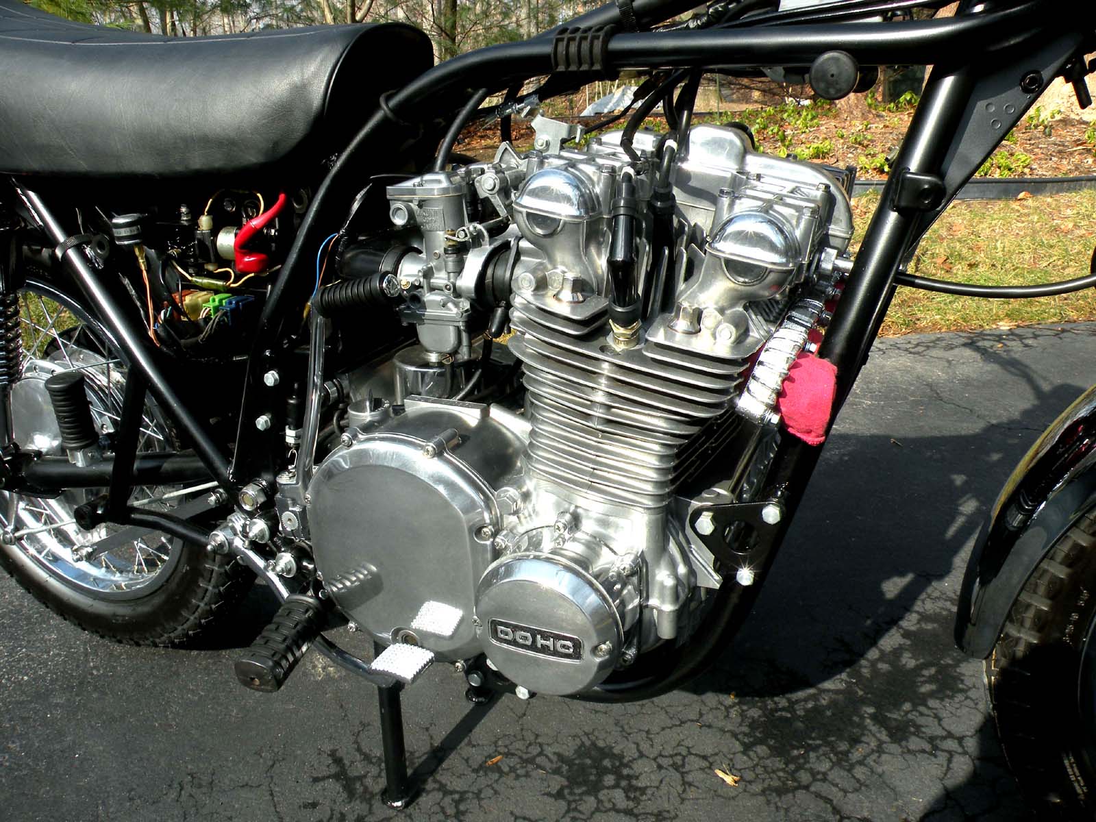

I can relate to the damage a Previous Owner can do with a spray can, Below are pictures of the 75 Z1B I'm finishing up. The PO had painted the engine all black (a blob). This engine was disassembled. I glass beaded the head and cylinder. The cases took numerous rounds of stripper and final cleaning with Nyloc wheel brushes. I'm OCD as well.
