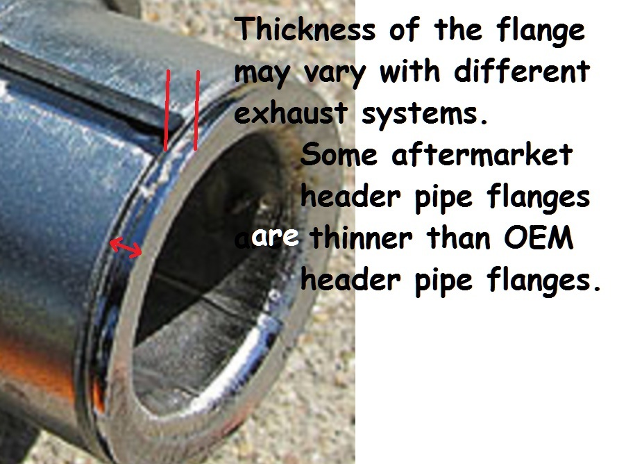

The 2 split collars or inserts that came with the header appear to be the approx. 1 mm longer than the stock ones which isn't much but maybe would be better to use?
And I don't this questioned was answered but seems to be obvious. You use your stock exhaust pipe holders or 1 piece collars to mount the header?

The aftermarket headers likely have a thinner flange thereby requiring slightly longer split collars to maintain the same clearances when tightening the clamps.

I had to re-use my split keepers...new ones with V&H header ARE too long...I actually uploaded a pretty nice set of old school header install instructions to the documents section a while back...MUCH better than the ones V&H provide! A daub of grease on the copper washers to keep them in place, masking tape on the split keepers...do yourself a favor, and put paper towel/TP tubes over your frame tubes to protect, & pull front fender! Make SURE that you only have ONE copper washer in there! Plus one on the exhaust paint inside, also!
