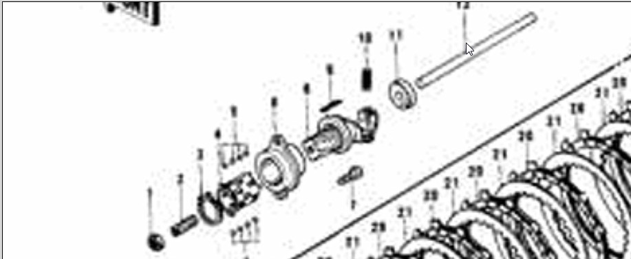

Seymore, like I said, I thought it was originally a stretched/snapped cable because it literally happened instantaneously. But when I took the sprocket cover off, it was totally normal and didn't seem to be damaged at all. And I did mess around with the adjustor nut on the actuator but I heard different sources saying it was supposed to be all the way clockwise then half turn out and another said all the way counterclockwise and then a half turn back. I tried both and was only able to get partial resistance in my lever before another pop. And for oil, I am currently using 10W-30 Rotella dino oil. Its what I run in all my bikes.
Bountyhunter, yeah I probably did find one of those mysterious neutrals in the trans. It has happened to me before. I was just not sure it was due to one of those neutrals or because of the clutch suddenly having problems. Because it was just after that when the clutch lever went crazy.
Do you know if the clutch push arm is supposed to freely rotate and should you be able to push it in with the cover off using your hand? Also, is it bad to pull it out entirely assuming you don't lose the small bearing? Any good ways to check on the clutch actuator system without removing the oil/right side cover?
Thanks!

02 Dec 2014 12:49My memory is:bpchura wrote: Do you know if the clutch push arm is supposed to freely rotate and should you be able to push it in with the cover off using your hand? Also, is it bad to pull it out entirely assuming you don't lose the small bearing? Any good ways to check on the clutch actuator system without removing the oil/right side cover?
Thanks!
The clutch throw out rod does turn freely.
I do not think you should be able to push it in by hand, there should be a lot of force required as it is working against the springs.
It doesn't hurt to pull the rod out but don't lose the ball bearing.

Hey all, sorry about the profile information and not telling all about the bike. I have tried many times to update my information but for some reason, the save button on the profile information form doesnt seem to work or do anything at all?
You guys are correct, the bike is a twin. Sorry about not mentioning that earlier.
I am glad that the push rod is supposed to spin,,,, I never noticed it before and am glad its not a big issue! I will pull the rod out and check on the condition on the bearing.
Is there a way to know if your actuator is overly worn? The bearings are in round and it seems that the pusher plate does have gouges in the surface but I cannot tell if it is an issue. Thanks for all your input everyone and I will update on the situation when I am able to dig into it.

02 Dec 2014 16:27
I tried to go to Kawasaki.com and get an explosion diagram of the actuator assembly but it only goes back to 1987 now. I guess those asswipes have thrown the rest of us under the bus.
