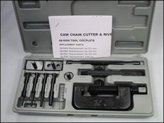

08 Jul 2014 20:20 - 08 Jul 2014 20:28Ive never actually done myself,thats why Im just guessing there has to be something involved other than just pounding on the pins to hold it together.kaw-a-holic wrote:PLUMMEN wrote: Yours uses the old style chain,did they sell you an install tool with it for master link?
No. So I guess that is my answer. I will buy a masterlink installation tool. TY
Im going to do a little investigating also.
Heres what z1 enterprises lists for a cam chain tool,around $90.00

You can buy the same kit in auction web sites for $25.

I happen to know of a guy that used a master link in his cam chain when he rebuilt his 77 KZ1000. He used the rivet tool pictured above and worked fine. The only thing I (I mean "he") advises is to not go crazy with the tool. It's easy to go to tight and bind up the link. I ( I mean "he") has several thousand miles on the motor now with no issues.

i already have the chain-breaker and rivet tool (Motion Pro) from Z1 Enterprises.
