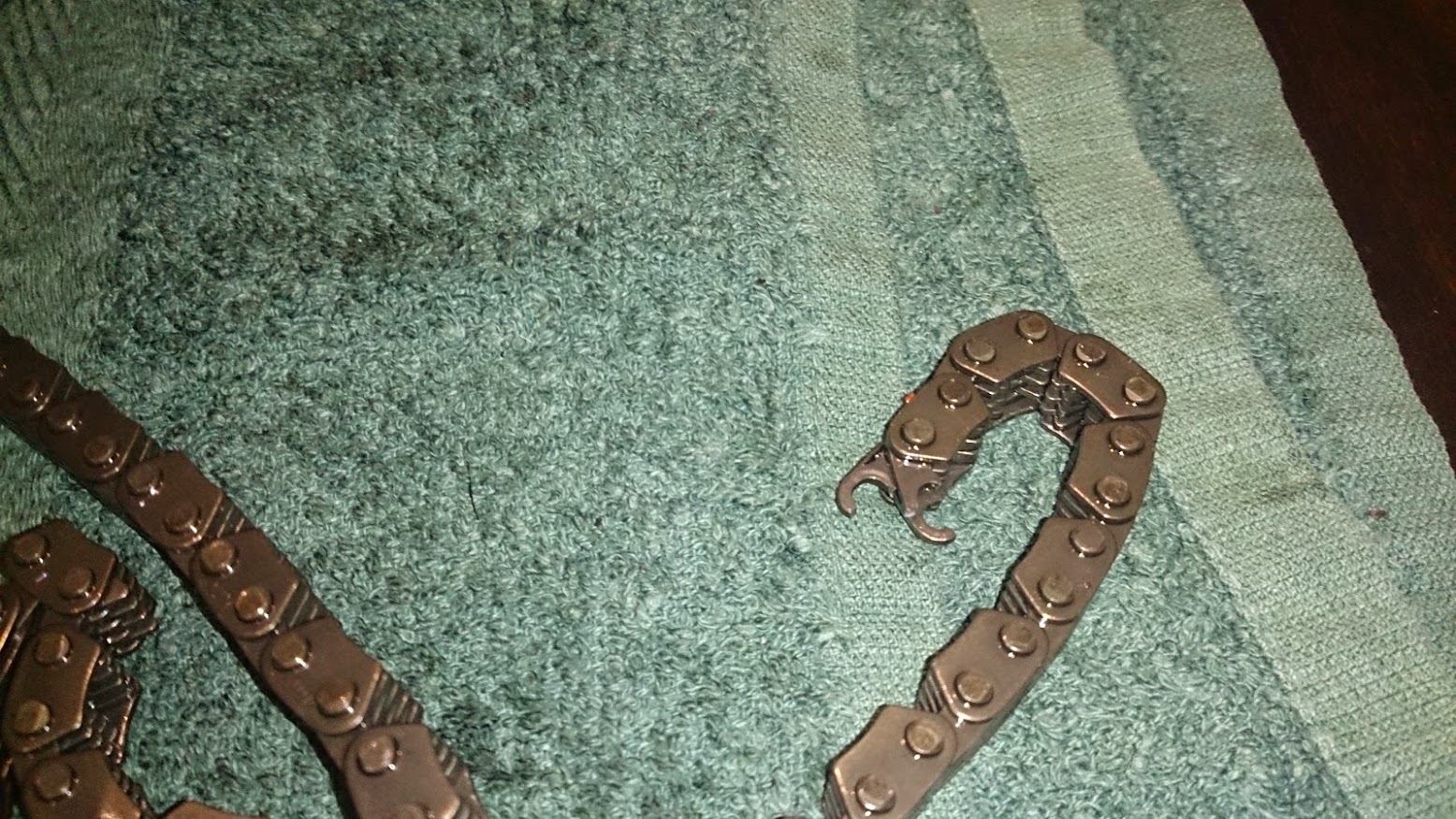

If it's been a soft/rivet link type I've seen quite a few of those Hyvo's fail, even with good quality DID chain.
Either due to the link pins being riveted overly tight ( mostly from not using the correct tool) or failure of the links pins due to brittleness/faulty heat treatment.
It's false economy to fit a rivet link chain as they are notoriously difficult to rivet correctly and at the high mileages they do the rest of the motor usually needs a look at anyhow when it's time to change them.,

After looking closer at the cam chain and the top, I believe I have found the reason for the chain breaking. I don't believe that there is anything wrong with the quality of the chain, but simply that I've failed to tigthen it enough. I guess I needed to learn this the hard way :blush:
Here is a photo of the broken chain:

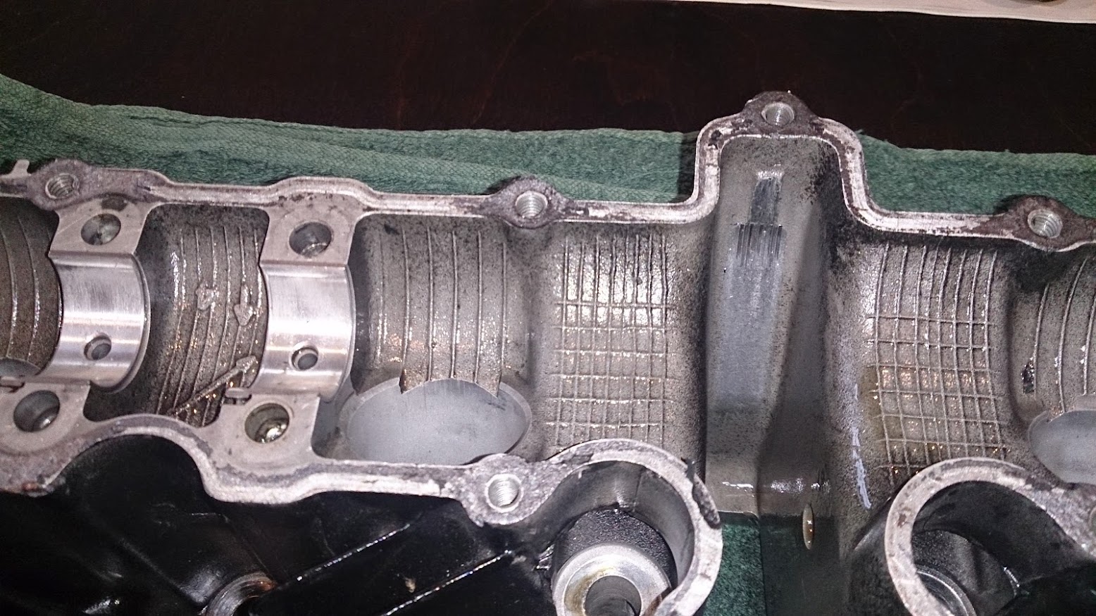

To me it seems that the chain has snagged on the inside of the head, i can see marks on the little knob on the inside towards the exhaust:
Also on the other side towards the carbs;
I can even see that there is another part on the chain where two links have broken:

Next time after you have the cams in and the valve cover on put a 17mm wrench on and rock the crank back and forth while turning the adjuster in.

I would take a close look at that exhaust valve guide
