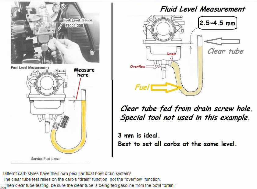

Check to ensure the carb float valve is operating properly and not sticking open. Also, check the fuel level in the carb using the clear tube method (see image below) to see if it is set too high or too high due to a sticking float valve. Check your manual for the correct fuel level. Ed

14 Jun 2014 09:32 #636607
by Tbur5616
1978 kz200.
Replied by Tbur5616 on topic 1978 kz200 gas leaking into oil
Oh, never thought of the tube method, that is awesome! I will try. Thanks!

Nope, fuel level great. Starts smoking out tailpipe about 3 seconds after it starts. pulled spark plug, cylinder full of smoke.

Float is cutting off fuel before any overflowing is happening. Keeps the fuel level around 5mm below the gasket on the carb (where the bottom comes off). I ordered new cylinder rings for $25 bucks and am going to try that. If that fails, I am out of answers. Hopefully I will get to ride soon!!! I have only ridden a couple times in my life, this was a bike my dad gave me to learn to ride on. Instead, I have learned mechanic skills! $600 and 2 years later, I am still hoping to ride it eventually. It sure was fun to ride a few blocks before it died and I had to push it back! Cheers.
