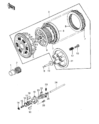

The parts diagram at kawasaki.com shows 1979 KZ1000 LTD as having a different clutch adjuster mechanism than the KZ900.
The KZ900 screw type is for sure turned in til seated, then out 1/2 turn.
Some of the later styles turned out til seated, then in 1/2 turn.
If the adjuster fails to produce the desired results when following manual, hurts nothing to attempt adjusting in the reverse order of turning the screw.
Is there specified slack in the clutch cable at the handlebar lever perch?
Are both cable ends fully seated in the mid-cable adjuster?
Is the cable fully seated inside the sprocket cover?
Is the adjuster mechanism correctly installed (properly oriented) inside the sprocket cover?
1979 KZ1000 LTD clutch is different than either of the above diagrams.
I don't know which way the 1979 KZ1000 LTD is actually supposed to be turned first in order to lightly seat the end of the screw against the push rod.
But I do know it doesn't hurt to try it both ways. :lol:
