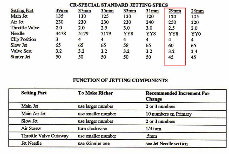

CR 29 carb jetting.
I can't seem to find anyone with a kz and these carbs and find what their jetting is.
My jetting is:
- 110 main jet
- 65 slow jet
- needle in middle position
- uni air filters
Seems okay, but I think it's a hair too rich still.
Plugs look decent. But it's not perfect yet.
Does anyone else have these carbs and let me know what type of settings you have?

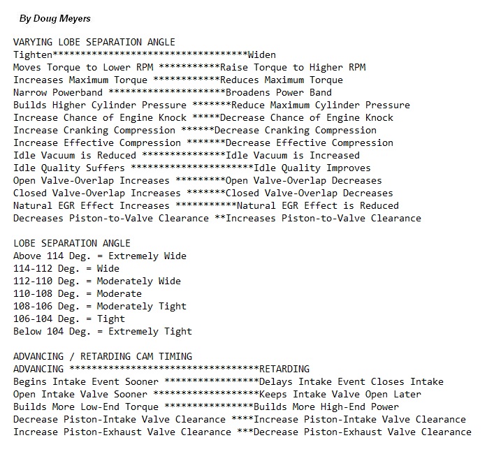

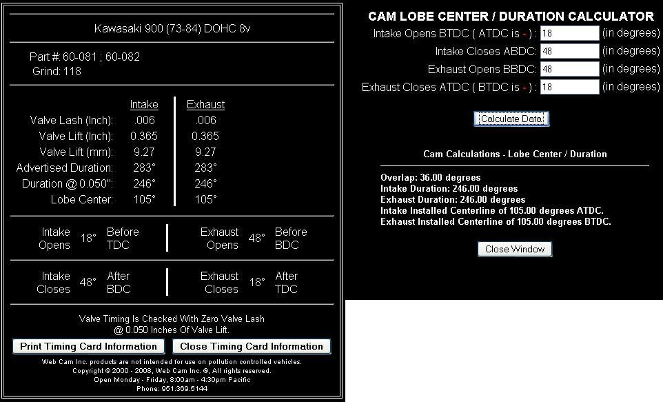

I had that exact same build the first time so a couple things....
Those cams are designed for 105 lobe centers, pretty tight but you have them at stock 110 LC...
So you will notice a difference (lower compression) in psi measurements with wider spread... As long as all 4 are reading the ~ same @ 125psi you're ok...
140-150 would be the normal reading on that build.
Slow jet and needle Jetting is rich...
I'm @ 1200 elevation, high temps so may be different than your location.
slow jet 52...
Needle YY9 clip position 4
Main 120
Maybe this will help...
