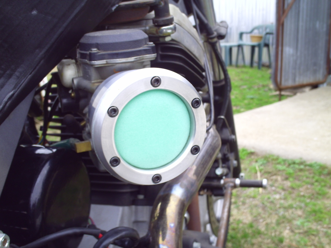

i machined my own air cleaner housing and cut a filter out of a sheet of uni foam filter material.
www.amazon.com/Uni-Air-Filter-Bulk-Foam/dp/B003V3O0YK
hth,
hth,
Last edit: 17 Sep 2013 17:02 by 531blackbanshee.

Like I wrote, I'm sure it's H.D. aftermarket :pinch: .....I remember seeing those in the 80's .....most any filter/housing that fits a zenith/bendix will work with 3 mounting holes.... I would worry about airflow with the filter in the link provided. :pinch: I would go with the UNI foam replacement like 531blackbanshee wrote :woohoo: ......free flowing for the turbo :ohmy:

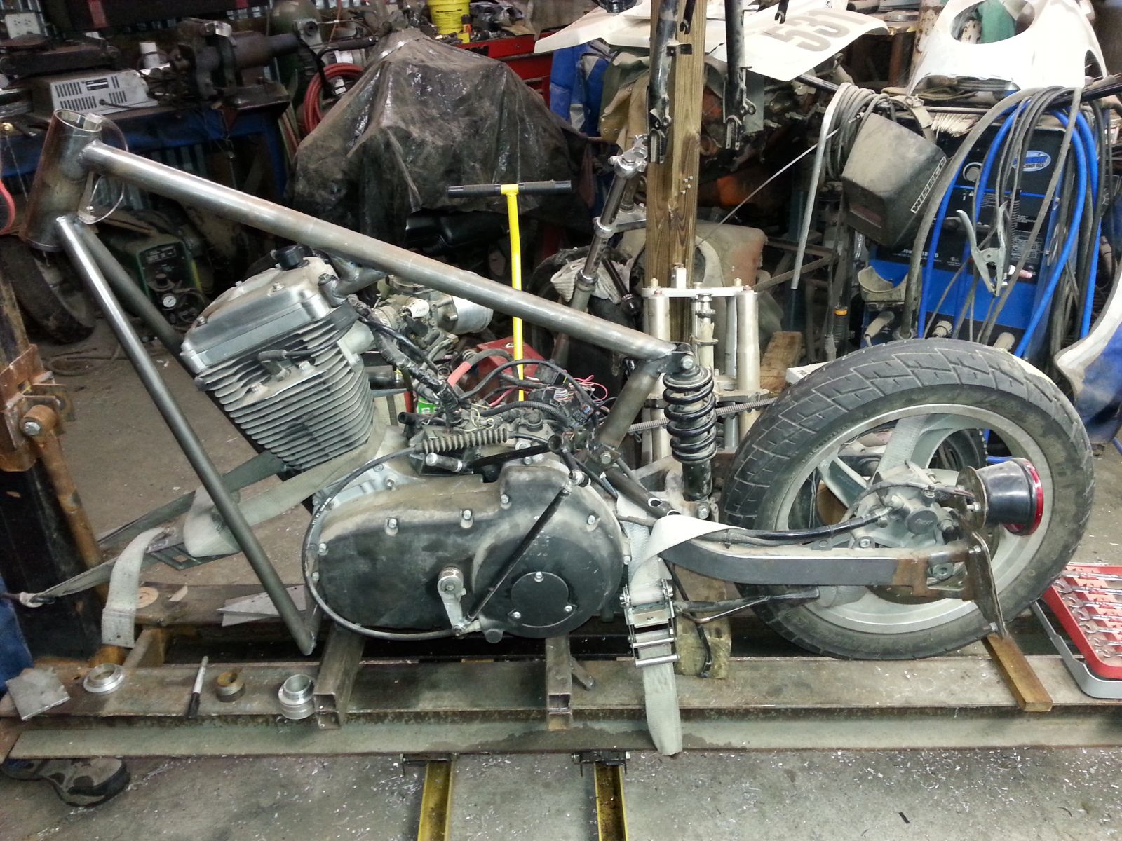

18 Sep 2013 14:24531blackbanshee wrote: i machined my own air cleaner housing and cut a filter out of a sheet of uni foam filter material.
hth,
Is that on the Blast?

testa that is on the blast.
which is looking more like this nowadays (night before last),
mockup with the tank and front end.
