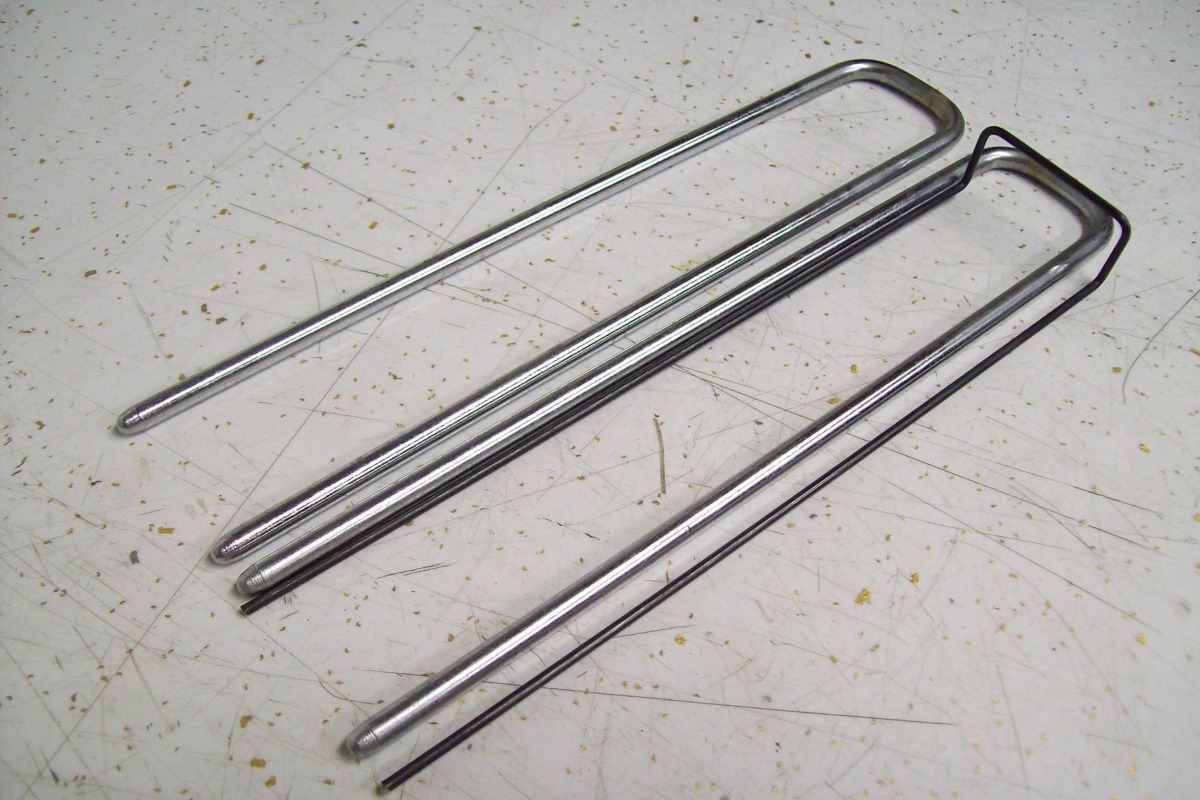

Those wire piston holders only work with stock Kz1000 pistons. If you have aftermarket pistons like Wiseco, you will need something bigger in diameter to keep all four pistons level. You can use wooden dowel rods, or even the round shafts of Phillips screwdrivers!!! Here are a few photos of a pair of bigger diameter piston holders for the Kz1000S1. These work on my Moriwaki 1105cc pistons. Don't use anything that will scratch the piston skirts. I don't remember ever needing a smaller diameter wire on any set of piston I have ever seen.
If your piston tool has 57001-532 on it, THAT IS THE RIGHT TOOL FOR USE ON 70mm KZ1000 pistons. 57001-531 is for the 900cc 66mm pistons. Got no idea what the part number is for a 650cc tool, and I really don't care!!!! I am not going to bore you with a photo of the 57001-532 from the Kawasaki shop manual. I have been using the 57001-532 tool on Kz1000's since back in 1977, so I know it is the right tool.

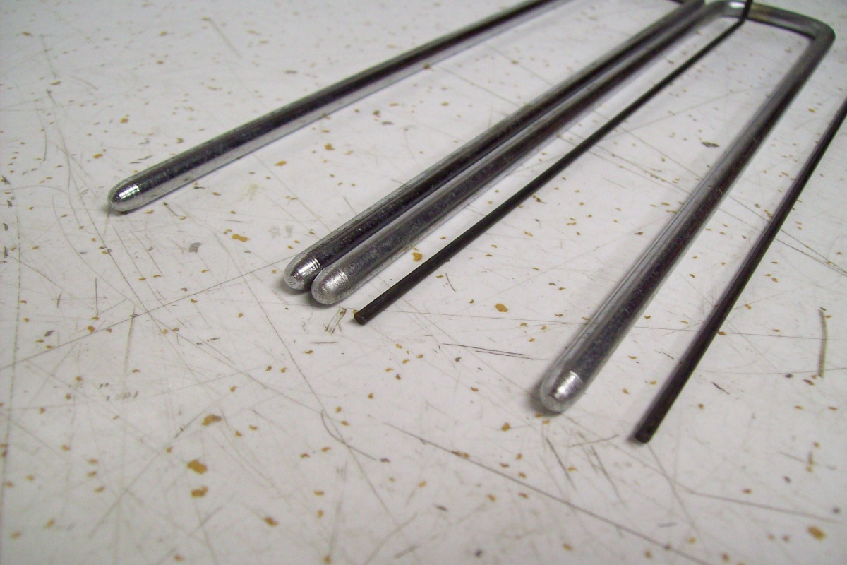

Here are the Kz1000S1 piston holders next to one of the standard Kz1000 piston holder wires.
You can see the difference in the diameter between the two in this photo.
