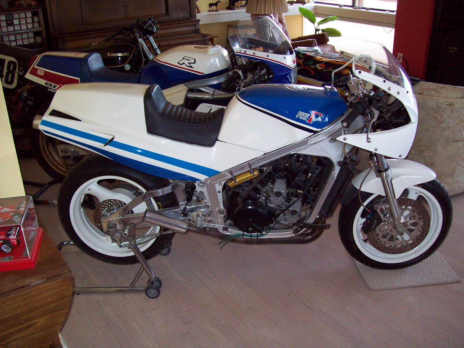

I have a 1985 RZ500 Yam V4 2-stroke being shipped from the East Coast on an Allied Motorcycle Transport truck due to arrive here in a week, can't wait to tear into that project.""" From newOld_kz1000
I come from the Land Of Lincoln where anything can be had for a price. Judges, presidential elections, and a title for a Gamma!!! A "small" contribution for someone running for Governor in Illinois will get you a title for your Gamma!!! I think like 5 out of the last 6 Governors of Illimois are in prison, or have served time. Like they say in Crook County, vote early, and vote often!!!
I hope its legal to post a photo of a non-Kawasaki bike. Or should I say how much will it cost me to post a picture of a non-Kawasaki motorcycle??

Nice RG, I can't help but notice the large cast aluminum frame section at the gooseneck, the whole 500 Gamma frame must have been aluminum like the GSXRs which was pretty exotic in 1986.
My Rz500 has the steel frame, only the Japan-market RZ500s had aluminum frames, dang it.
Incredible.
Nice LTD GSXR in the background there, hold on to that one, it's worth more ultimately than most baby boomers have saved for retirement!
Incredible.

Thanks. You can definitely tell the RG500 and the first GSXR's were designed at the same time when you park both side by side. The frame tubing are identical on both bikes.
No, my Limited is not stock anymore. The big buck Limiteds are the ones that somebody kept all stock. I cut on the fairing so all the Yoshimura goodies would fit. And I threw away that stupid looking rear fender, and plate lamp. Plus this and that was added. Just can't see keeping ANY sportbike stock for more than a week in my book.
