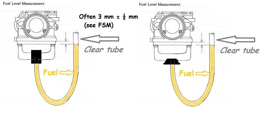

01 Apr 2013 12:25 - 01 Apr 2013 13:28Setting float height to spec often fails to produce the correct fuel level.treitz wrote: ...I adjusted the float height, but am having a hard time adjusting it to stock because I don't have the adapter for a clear hose test. I measure the float and think it is to spec.....
Fuel level is critical.
Whatever float height results in correct fuel level is the correct float height, regardless of what the dry upside-down on the workbench float height measurement happens to be.
The clear tube test may be performed without the special tool.
Use a size tube that fits snugly or self-threads into a side-located drain hole.
For carb having a large bottom drain hole, use a rubber grommet or short section of hose that fits snugly into the hole, and add a length of clear tube that fits snugly inside the grommet or larger hose section.
(This works for example on Mikuni smoothbore carb.)

I have the large bottom drain hole. So I'll have to find some sort of grommet or hose that will fit in the hole I guess.

01 Apr 2013 13:32Short section of oil hose will usually suffice.treitz wrote: I have the large bottom drain hole. So I'll have to find some sort of grommet or hose that will fit in the hole I guess.
Minimal fuel seepage won't adversely affect the clear tube test.

Thanks for the diagrams Patton. I found a rubber grommet in my garage that worked perfectly. My initial measurement showed 0 or "level." So I adjusted it to drop it to 3mm.
