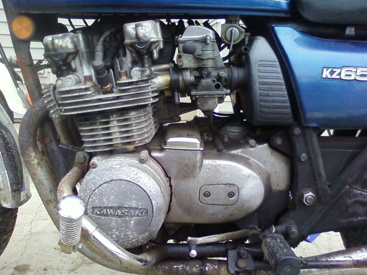

My spare 1000 engine needs paint removed so I've been watching this thread closely.
I think paint stripper and elbow grease is the way I'll go.
I'm not having to deal with any plating and paint on my sons 650 so I'm melting the grime off with the WD-40 and a scotch brite pad followed up by Mothers aluminum polish then on to aircraft polish and we are getting real good results.
The WD loosens up everything and leaves a dull finish with some dark spots in it , the Mothers is removing most of the dark spots and when I applied the first part of the air craft polish, WOW!
I still have to apply the conditioner but will wait till everything else is caught up.
Before polishing the jugs and casings I will take the engine out side and give it a good spray down with engine cleaner and rise with water.
I'm using it on the carbs too ,trying to keep it out of the ports and wiping it off with paper towels.
Finishing up with carb cleaner and getting good results.
Sorry for the crappy after pic I need a new phone :lol:
