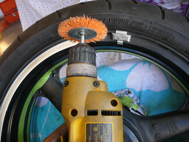

- Old Man Rock
- Posts: 6071
- Thanks: 225
Re: Using "Simple Green" on my Z1R's engine
24 Mar 2013 09:44
Holly shit... You trying to accomplish this with the engine still in the frame... :blink:
Since you're obviously not worried about the engraving (sand blasting)....
The medium "Nylon" drill wheel is all I used with simple green on both engine builds, frame factory paint stripping, rims etc.... Try it out for ~ $10 (ACE hardware, Lowes, Home Depot, Harbor Freight Tools (
<$10) ) versus a couple hundred dollar compressor, medium, messy clean up etc....
These even took off the hard as hell OEM rim paint.
