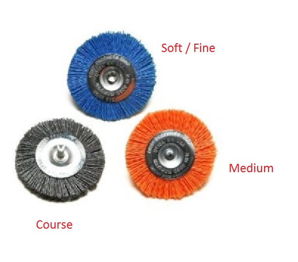

As oxidized as it is :pinch: , will take more than one overnight treatment.
One thing I didn't think of is in your covers being being chromed, not sure what difference that would make if any.
Soft nylon brush wheel would take the heavy oxidization off but seems your covers have some kind of design in them (see fork legs). Going to be a bitch no matter what.
Drill attached NYLON wheels for harder build ups followed by SG....
Keep at it and definitely post Pre & post images once completed....

20 Mar 2013 11:42Old Man Rock wrote: As oxidized as it is :pinch: , will take more than one overnight treatment.
Dude, you are a font of righteous help here -- I've never used the nylon drill-attached brushes you mentioned and likewise didn't know there was a color coding system to help figure out which ones to buy -- thanks for that -- I have been using all the following handheld tools on the whitish deposits on my aluminum engine bits:
- wire brush
- stainless-steel pot scrubber, the roundish hand-held wad of stainless (akin to a brillo pad) you find at any kitchen sink for scrubbing pots and pans, very coarse
- metal-blade scraper on the thicker parts of the whitish deposits
I don't know much about the chroming process, but I'm wondering if the whitish deposits that are hard stuck on my aluminum engine covers are remnants of the chroming process.
In any event, I've doused the motor a few times yesterday with phosporic acid and today I'll rinse it off, take my drill and those nylon wheels to it and will post pictures.

where is a good place to find the nylon wire wheels(cheap)? :huh:

I've seen those nylon wheels for about $12 at Ace Hardware
