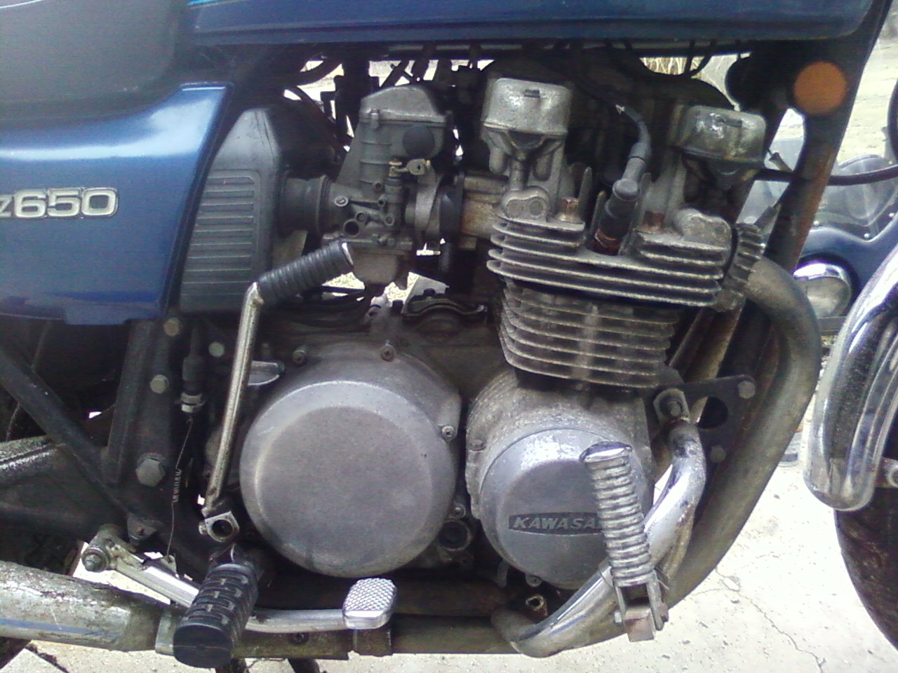

My '78 Z1R engine is oxidized and I'm trying the technique someone else on the board here recommened to remove the oxidation -- "Simple Green." Bought 3 spray bottles at Wal-Mart today, only $2.99 each, wow.
HERE'S THE RIGHT OF THE Z1R MOTOR TODAY *BEFORE* SIMPLE GREEN DOUSING:
THIS IS ABOUT 1 MINUTE AFTER SPRAYING LIBERALLY THE RIGHT SIDE OF THE MOTOR WITH SIMPLE GREEN -- LOOKS MUCH BETTER AFTER ONLY 1 MINUTE -- LOOK AT HOW THE FACTORY BLACK ENGINE PAINT LEAPS OUT NOW:
(the points breaker stuff is rusted junk, I have a brand new points breaker contacts ready for install, later.

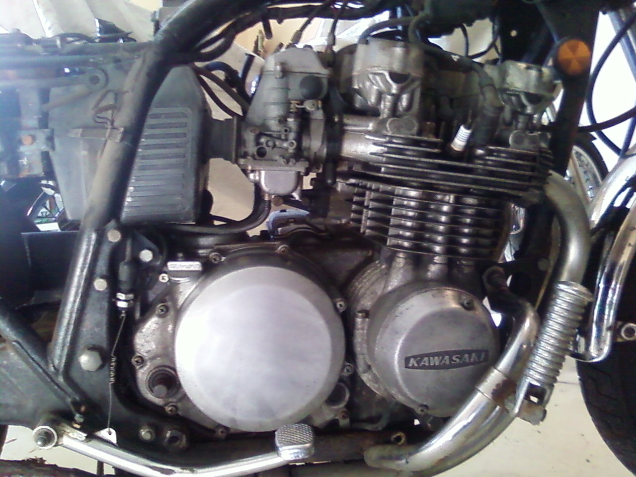

LEFT SIDE, BEFORE SIMPLE GREEN SPRAY-DOWN....
LEFT SIDE OF THE ENGINE, 1 MINUTE AFTER SIMPLE GREEN WAS LIBERALLY APPLIED....
As per the suggestion, I'm going to leave it soaking all night then see what it looks like tomorrow.

The 'Simple Green' did not have the desired effect, even after scrubbing hard with a brush. The whitish oxidation ? or whitish remnant underlayment put on the engine pieces prior to chroming ? are still there, heavy whitish deposits on all parts of the formerly-chromed engine pieces.
Recall that my engine cases were chromed in the past (this is a weathered 1978 Kawasaki Z1R Kz1000D) and that the bike sat outside near the ocean since the early 1980s and that I mentioned all the chromed engine covers - the clutch cover, left side alternator cover, camshafts cover, countershaft sprocket cover -- that those pieces had all the chrome peeling off due to 30 years outside exposure to near-the-ocean air.
And here's what I started with after removing all the flakes of chrome:
So the Simple Green was *no* match for all this whitish crusty stuff on the engine cases.
