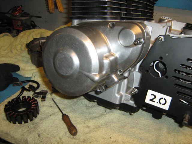

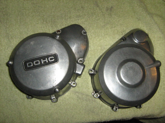

The reason I want it off is that I want to convert from the boring -82 cover to the nicer -79 one.
Have an old crank where the rotor is stuck on and need it for the other engine.

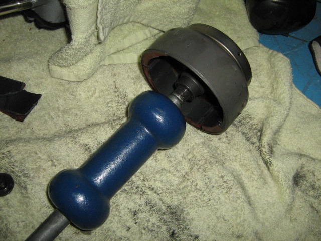

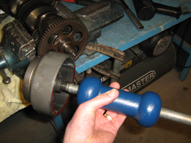

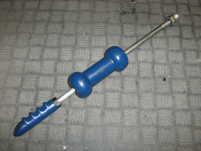

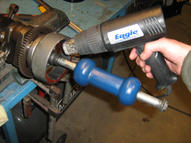

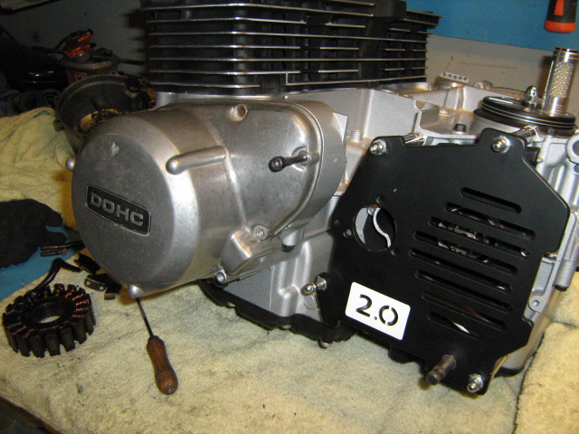

Yet another way to pull your rotor off:
1. Pull out your rear axle and screw it in to the rotor
2. Take the "hammer part" from your impact hammer and mount it on the axle.
3. Add some heat...some good heat for 5 minutes
4. Start hammering
5. Tighten the axle into the rotor some more
6. Hammer some more...
7. Tighten the axle some more..
8. One more whack and the rotor is yours ! :woohoo:
The impact hammer
Hammer mounted on the axle
The rotor is yours
