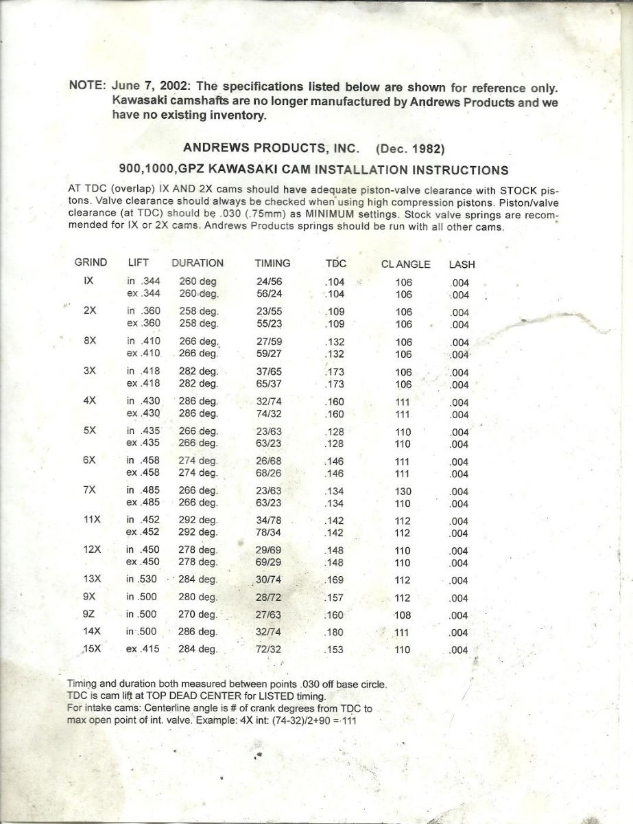

Re: Questions about andrews cams
22 Jan 2022 12:24
Thanks, I do have the specs for the 8X. Old cams! Andrews stopped making Kaw cams in late 80's
The old .410" cams. Everyone used to say! Looking for some .410 cams. guys I knew did use shim on top with these. I used shim on top with same 3X cams in 3-4 different engines
Like Jay from APE said the bought specs and APE still sells these type for $600 bucks.
Thanks for replies.
